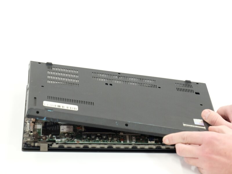

      • Turn your Lenovo ThinkPad L14 Gen 2 so that the bottom of the laptop is facing upward.
      • Using a Phillips #00 screwdriver, unscrew the nine 5 mm spring secured screws.
      Ask FixBot
    2. Lenovo ThinkPad L14 Gen 2 Back Panel Replacement: step 2, image 1 of 1
      • Gently push an opening pick between the back panel and the keyboard top.
      • There will be some resistance, so use some force.
      Ask FixBot
    3. Lenovo ThinkPad L14 Gen 2 Back Panel Replacement: step 3, image 1 of 1
      • Slide the pick along the entire perimeter of the laptop.
      Ask FixBot
    4. Lenovo ThinkPad L14 Gen 2 Back Panel Replacement: step 4, image 1 of 1
      • Remove the back cover.
