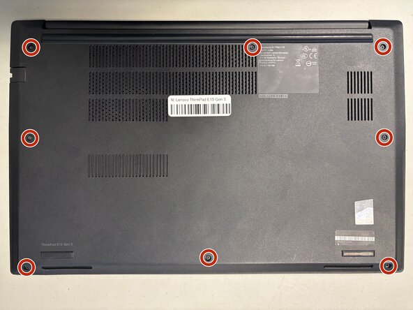

    1. Lenovo ThinkPad E15 Gen 3 Trackpad Replacement, Trackpad: step 1, image 1 of 3 Lenovo ThinkPad E15 Gen 3 Trackpad Replacement, Trackpad: step 1, image 2 of 3 Lenovo ThinkPad E15 Gen 3 Trackpad Replacement, Trackpad: step 1, image 3 of 3
      • Loosen the eight Phillips #1 captive screws using a Phillips #1 screwdriver.
      • Slide the opening pick between the upper case and the bottom cover.
      • Slide the pick around the perimeter of the case to disconnect the clips while gently pulling upwards with your free hand.
      • Lift the case upwards.

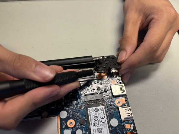

    4. Lenovo ThinkPad E15 Gen 3 Trackpad Replacement: step 4, image 1 of 3 Lenovo ThinkPad E15 Gen 3 Trackpad Replacement: step 4, image 2 of 3 Lenovo ThinkPad E15 Gen 3 Trackpad Replacement: step 4, image 3 of 3
      • Use a screwdriver to lift up the hinge.
      • Rotate the hinge by 180°.

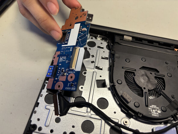

    5. Lenovo ThinkPad E15 Gen 3 Trackpad Replacement: step 5, image 1 of 1
      • Lift the I/O board out.

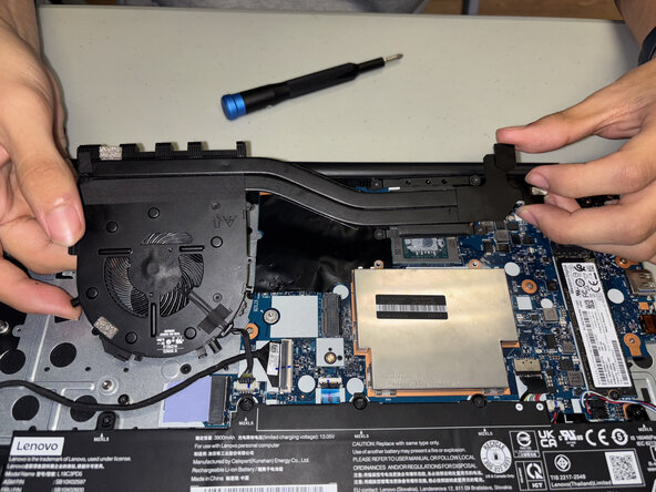

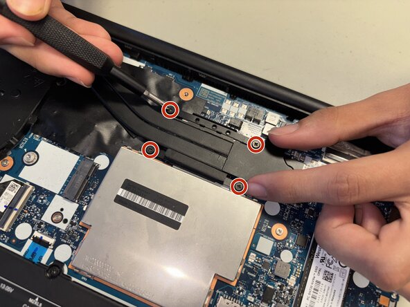

    10. Lenovo ThinkPad E15 Gen 3 Trackpad Replacement: step 10, image 1 of 3 Lenovo ThinkPad E15 Gen 3 Trackpad Replacement: step 10, image 2 of 3 Lenovo ThinkPad E15 Gen 3 Trackpad Replacement: step 10, image 3 of 3
      • Loosen and remove all screws securing the fan and heatsinks assembly using a Phillips #1 screwdriver.
      • Lift the heatsink and fan assembly directly upwards using both hands.
      • Place the fan assembly aside with the thermal paste facing upwards to avoid catching debris.

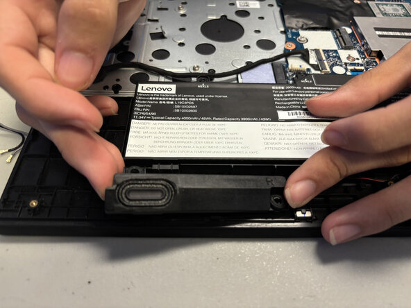

    11. Lenovo ThinkPad E15 Gen 3 Trackpad Replacement: step 11, image 1 of 3 Lenovo ThinkPad E15 Gen 3 Trackpad Replacement: step 11, image 2 of 3 Lenovo ThinkPad E15 Gen 3 Trackpad Replacement: step 11, image 3 of 3
      • Extract and remove the left and right speakers.
      • Pull back the cord.

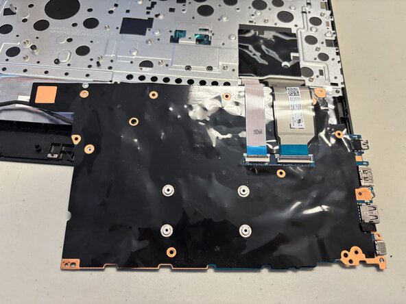

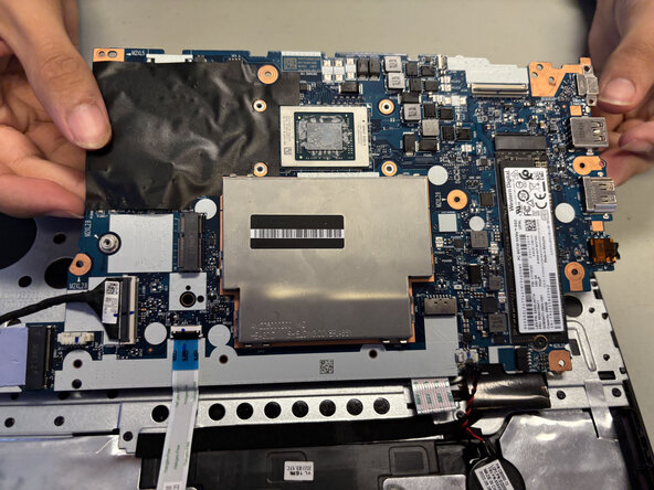

    16. Lenovo ThinkPad E15 Gen 3 Trackpad Replacement: step 16, image 1 of 3 Lenovo ThinkPad E15 Gen 3 Trackpad Replacement: step 16, image 2 of 3 Lenovo ThinkPad E15 Gen 3 Trackpad Replacement: step 16, image 3 of 3
      • Lift the motherboard.
      • Flip the motherboard so that it is now upside down.
      • Remove the two ribbon cords by gently sliding them backwards.

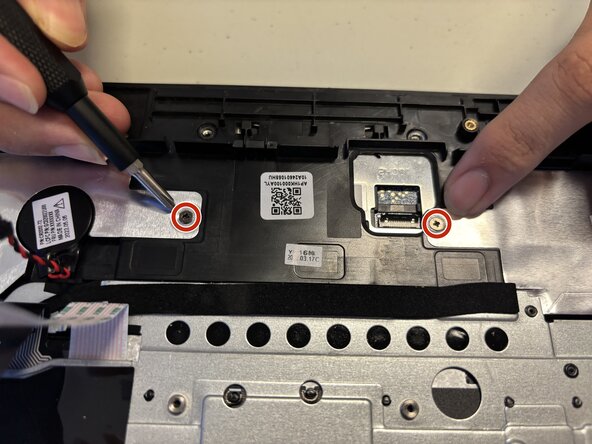

    17. Lenovo ThinkPad E15 Gen 3 Trackpad Replacement: step 17, image 1 of 2 Lenovo ThinkPad E15 Gen 3 Trackpad Replacement: step 17, image 2 of 2
      • Remove the four black 2.3mm screws using a Phillips #1 screwdriver.
