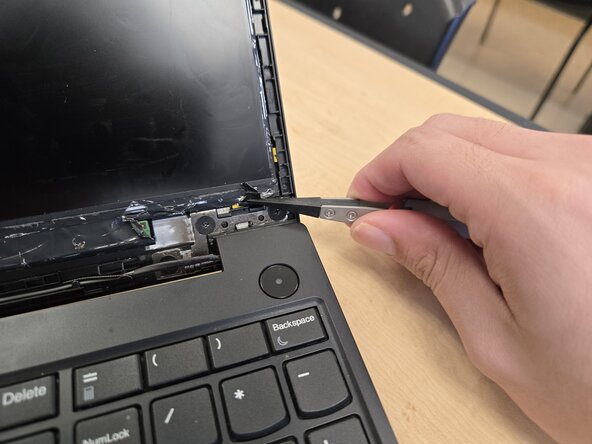

    1. Lenovo ThinkPad E15 Gen 3 LCD  Replacement, LCD: step 6, image 1 of 3 Lenovo ThinkPad E15 Gen 3 LCD  Replacement, LCD: step 6, image 2 of 3 Lenovo ThinkPad E15 Gen 3 LCD  Replacement, LCD: step 6, image 3 of 3
      Tool used on this step:
      Jimmy
      $7.95
      Buy
      • Slide a Jimmy right underneath the plastic cover of the screen.
      • Slide the Jimmy Across the cover in a clockwise motion.
      • Press the Laptop down and pull the plastic piece upwards until it un-clicks.
      • Recommended to use two hands for this.
      Ask FixBot
