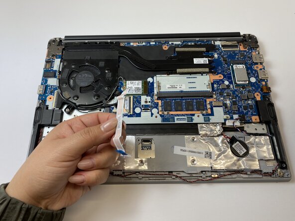

    1. Lenovo ThinkPad E14 Gen 4 Trackpad Replacement, Trackpad: step 7, image 1 of 1
      • Using a screwdriver, remove the screws securing the trackpad beneath the central metal plate (directly under the battery).
      Ask FixBot
    2. Lenovo ThinkPad E14 Gen 4 Trackpad Replacement: step 8, image 1 of 1
      • Pry the tab connector loose from its socket on the trackpad cable.
      Ask FixBot
    3. Lenovo ThinkPad E14 Gen 4 Trackpad Replacement: step 9, image 1 of 2 Lenovo ThinkPad E14 Gen 4 Trackpad Replacement: step 9, image 2 of 2
      • Lift the metal plate up and away from the chassis to expose the trackpad underneath.
      • Remove the trackpad from the laptop.
