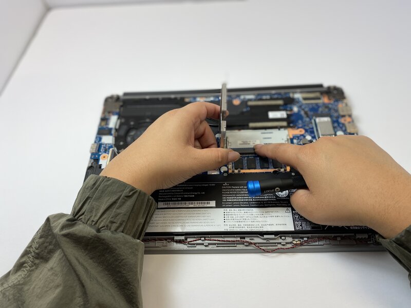

    1. Lenovo ThinkPad E14 Gen 4 RAM Replacement, RAM: step 7, image 1 of 2 Lenovo ThinkPad E14 Gen 4 RAM Replacement, RAM: step 7, image 2 of 2
      • Use a Phillips screwdriver to remove the screws holding down the RAM.
      • Push the metal retention clip away from the side of the RAM stick until the RAM pops up at an angle, then slide it out of the slot.
