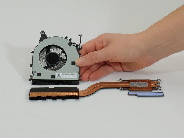

      • Lift the fan and heatsink out of the device.
      • They are attached at the base and can come apart, but only separate them for replacement and/or cleaning.
      Ask FixBot
    5. Lenovo ThinkPad E14 Gen 4 Keyboard Replacement: step 11, image 1 of 3 Lenovo ThinkPad E14 Gen 4 Keyboard Replacement: step 11, image 2 of 3 Lenovo ThinkPad E14 Gen 4 Keyboard Replacement: step 11, image 3 of 3
      • For cleaning the fan, detach it from the heatsink and flip it over.
      • Unscrew the four 3mm Phillips #1 screws and lift the back plate off to provide direct access to the fan.
      Ask FixBot
    6. Lenovo ThinkPad E14 Gen 4 Keyboard Replacement: step 12, image 1 of 2 Lenovo ThinkPad E14 Gen 4 Keyboard Replacement: step 12, image 2 of 2
      • The thermal paste may need to be replaced before you put things back together. Look for the spot the heatsink was previously attached; if the surface seems dried out, that will need to be removed.
      • Make sure you remove all of the old thermal paste before applying new paste.

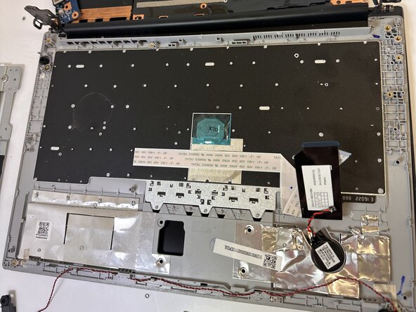

    1. Lenovo ThinkPad E14 Gen 4 Keyboard Replacement, Keyboard: step 16, image 1 of 3 Lenovo ThinkPad E14 Gen 4 Keyboard Replacement, Keyboard: step 16, image 2 of 3 Lenovo ThinkPad E14 Gen 4 Keyboard Replacement, Keyboard: step 16, image 3 of 3
      • Use a spudger to remove the metal panel from the computer.
      Ask FixBot
    2. Lenovo ThinkPad E14 Gen 4 Keyboard Replacement: step 17, image 1 of 3 Lenovo ThinkPad E14 Gen 4 Keyboard Replacement: step 17, image 2 of 3 Lenovo ThinkPad E14 Gen 4 Keyboard Replacement: step 17, image 3 of 3
      • Remove the keyboard from the laptop.
      Ask FixBot
