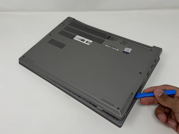

    2. Lenovo ThinkPad E14 Gen 1 RAM Replacement: step 2, image 1 of 2 Lenovo ThinkPad E14 Gen 1 RAM Replacement: step 2, image 2 of 2
      • Insert your opening tool into the space between the lower case and the chassis.
      • Gently slide the tool around the edges to release the clips securing the cover.
      • Remove the lower case.

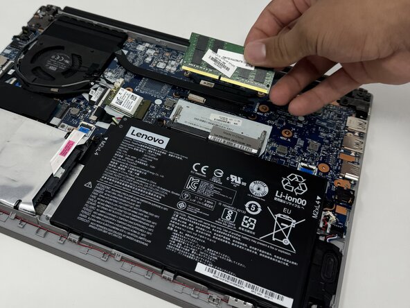

    1. Lenovo ThinkPad E14 Gen 1 RAM Replacement, RAM: step 4, image 1 of 3 Lenovo ThinkPad E14 Gen 1 RAM Replacement, RAM: step 4, image 2 of 3 Lenovo ThinkPad E14 Gen 1 RAM Replacement, RAM: step 4, image 3 of 3
      • Two clips secure each RAM module in place, one on each side. Using your fingers, spread the clips away from the RAM module.
      Ask FixBot
    2. Lenovo ThinkPad E14 Gen 1 RAM Replacement: step 5, image 1 of 3 Lenovo ThinkPad E14 Gen 1 RAM Replacement: step 5, image 2 of 3 Lenovo ThinkPad E14 Gen 1 RAM Replacement: step 5, image 3 of 3
      • Gently pull the module out of its socket.
      Ask FixBot
