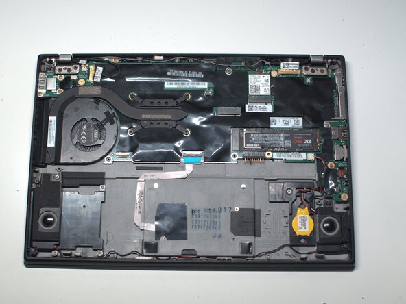

      • Flip your laptop over so the bottom panel is facing up.
      • Use a Phillips #0 to loosen the five screws holding the back panel to the laptop.
      • These screws do not come all the way out, so loosen until free spinning.
      • Lift the bottom of the panel to separate the back panel away from the device.
      • Remove the back panel.
