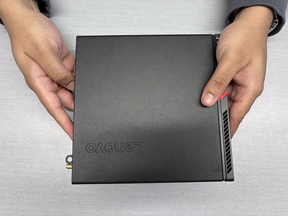

    • Remove all cables, locks, wireless receivers, and disc drive shrouds from the device.
    Ask FixBot
  2. Lenovo ThinkCentre M900 Tiny RAM Replacement: step 2, image 1 of 2 Lenovo ThinkCentre M900 Tiny RAM Replacement: step 2, image 2 of 2
    • Unscrew the single Phillips #1 screw on the rear side of the device.
    Ask FixBot
  3. Lenovo ThinkCentre M900 Tiny RAM Replacement: step 3, image 1 of 3 Lenovo ThinkCentre M900 Tiny RAM Replacement: step 3, image 2 of 3 Lenovo ThinkCentre M900 Tiny RAM Replacement: step 3, image 3 of 3
    • Slide the cover towards the front of the device to remove.
    Ask FixBot

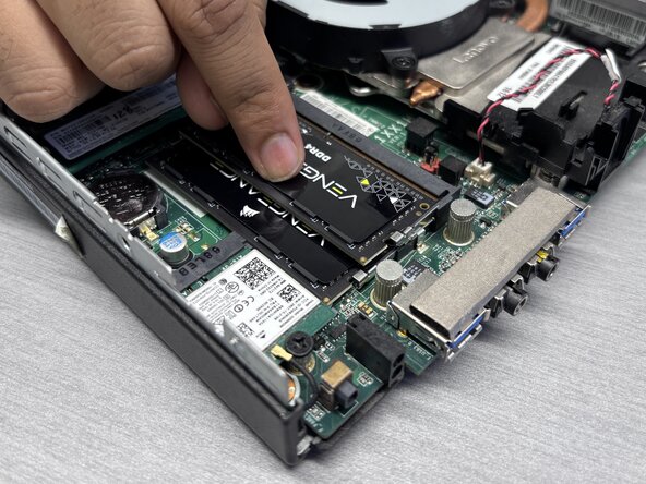

  6. Lenovo ThinkCentre M900 Tiny RAM Replacement: step 6, image 1 of 3 Lenovo ThinkCentre M900 Tiny RAM Replacement: step 6, image 2 of 3 Lenovo ThinkCentre M900 Tiny RAM Replacement: step 6, image 3 of 3
    • Gently push the silver latches on both sides of the RAM stick outward until the module pops up.
    • Slide the RAM out from the slot.
    • There should be little to no resistance when removing the modules.

  7. Lenovo ThinkCentre M900 Tiny RAM Replacement: step 7, image 1 of 3 Lenovo ThinkCentre M900 Tiny RAM Replacement: step 7, image 2 of 3 Lenovo ThinkCentre M900 Tiny RAM Replacement: step 7, image 3 of 3
    • Align the gold pins on the new RAM stick with the slot on the board and insert it at the same angle as the original RAM module was installed.
    • Gently press downwards on the RAM modules until the latches engage, holding the RAM modules in place.
    • Repeat steps 2-5 in reverse order to reassemble the device.
