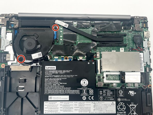

    1. Lenovo ThinkBook 14-IIL Trackpad Replacement, Fan: step 7, image 1 of 1
      • Remove the 5.3mm screws from the fan using a Phillips #0 screwdriver.
      Ask FixBot

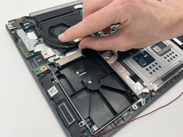

    3. Lenovo ThinkBook 14-IIL Trackpad Replacement: step 9, image 1 of 3 Lenovo ThinkBook 14-IIL Trackpad Replacement: step 9, image 2 of 3 Lenovo ThinkBook 14-IIL Trackpad Replacement: step 9, image 3 of 3
      • Pull up the wires next to the fan.
      Ask FixBot
    4. Lenovo ThinkBook 14-IIL Trackpad Replacement: step 10, image 1 of 3 Lenovo ThinkBook 14-IIL Trackpad Replacement: step 10, image 2 of 3 Lenovo ThinkBook 14-IIL Trackpad Replacement: step 10, image 3 of 3
      • Remove the fan from the laptop carefully while being mindful of the wires.
      Ask FixBot

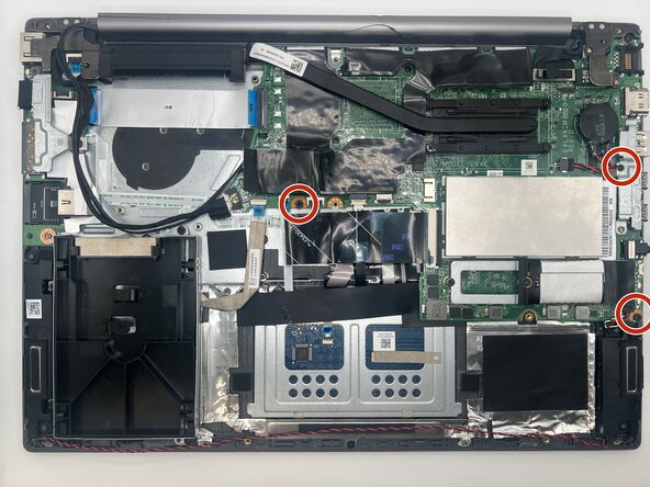

    2. Lenovo ThinkBook 14-IIL Trackpad Replacement: step 12, image 1 of 1
      • Remove the three 2.3mm screws from the motherboard using a Phillips #0 screwdriver.
      Ask FixBot

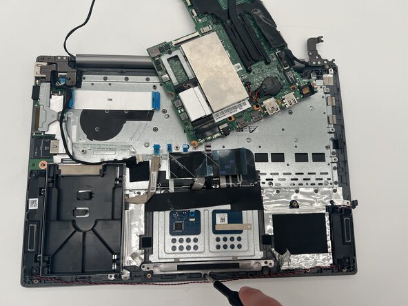

    6. Lenovo ThinkBook 14-IIL Trackpad Replacement: step 16, image 1 of 3 Lenovo ThinkBook 14-IIL Trackpad Replacement: step 16, image 2 of 3 Lenovo ThinkBook 14-IIL Trackpad Replacement: step 16, image 3 of 3
      • Gently remove the motherboard from the laptop by lifting it carefully upwards like a latch.
      • Safely relocate the motherboard off to the side for safety.
