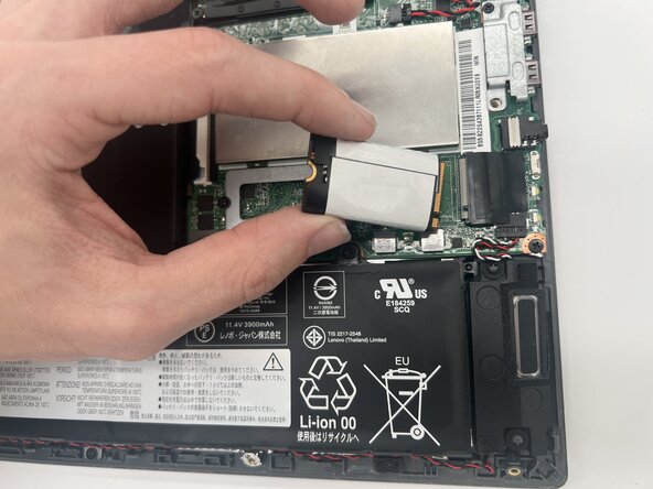

    1. Lenovo ThinkBook 14-IIL SSD Replacement, SSD: step 4, image 1 of 1
      • Remove the 3.8mm screw holding the SSD in place using a Phillips #0 screwdriver.
      • It will lift up on its own.
      Ask FixBot
    2. Lenovo ThinkBook 14-IIL SSD Replacement: step 5, image 1 of 3 Lenovo ThinkBook 14-IIL SSD Replacement: step 5, image 2 of 3 Lenovo ThinkBook 14-IIL SSD Replacement: step 5, image 3 of 3
      • Gently grab the SSD, and pull in the direction it has lifted towards.
