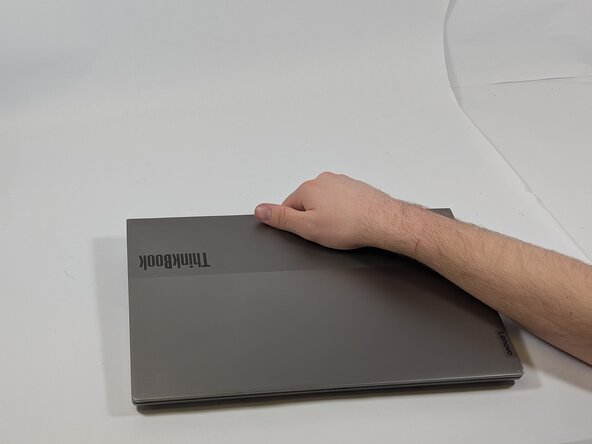

      • Ensure the laptop has been fully powered off and flip it upside down.

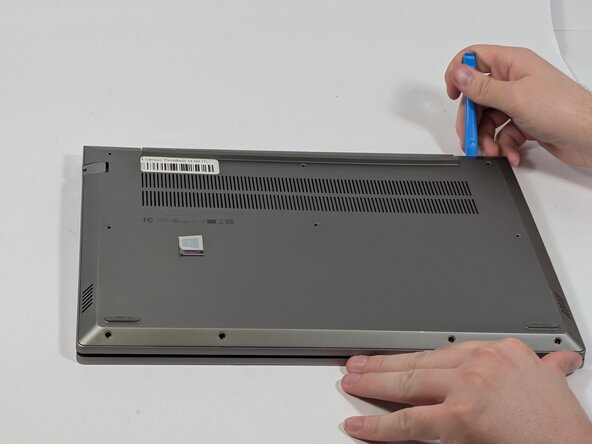

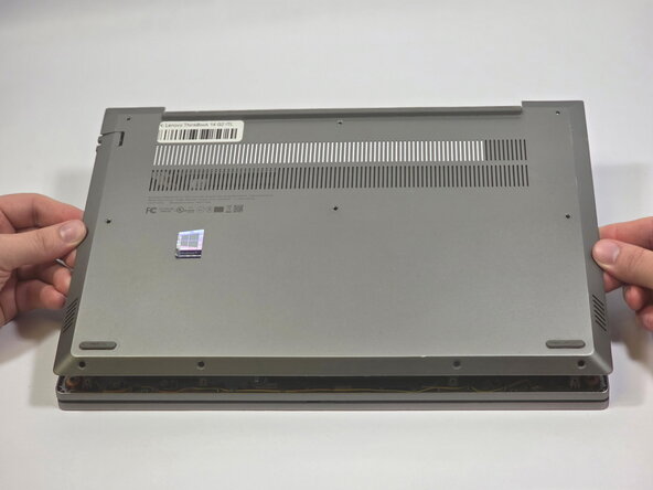

    3. Lenovo ThinkBook 14 G2 ITL CMOS Replacement: step 3, image 1 of 3 Lenovo ThinkBook 14 G2 ITL CMOS Replacement: step 3, image 2 of 3 Lenovo ThinkBook 14 G2 ITL CMOS Replacement: step 3, image 3 of 3
      • Use the opening tool to carefully remove the back cover.

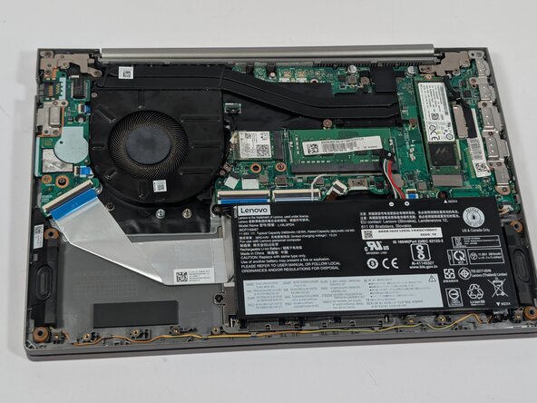

    1. Lenovo ThinkBook 14 G2 ITL CMOS Replacement, CMOS: step 4, image 1 of 2 Lenovo ThinkBook 14 G2 ITL CMOS Replacement, CMOS: step 4, image 2 of 2
      • Disconnect the battery connector from the battery terminal using the pointy end of the spudger.
      • Ensure the battery is disconnected before proceeding to avoid damage to the motherboard.
      Ask FixBot
    2. Lenovo ThinkBook 14 G2 ITL CMOS Replacement: step 5, image 1 of 2 Lenovo ThinkBook 14 G2 ITL CMOS Replacement: step 5, image 2 of 2
      • Disconnect the CMOS connector from the CMOS terminal with the pointy end of a spudger.
      Ask FixBot
    3. Lenovo ThinkBook 14 G2 ITL CMOS Replacement: step 6, image 1 of 2 Lenovo ThinkBook 14 G2 ITL CMOS Replacement: step 6, image 2 of 2
      • Peel off the CMOS battery from the I/O board with the flat side of a spudger.
