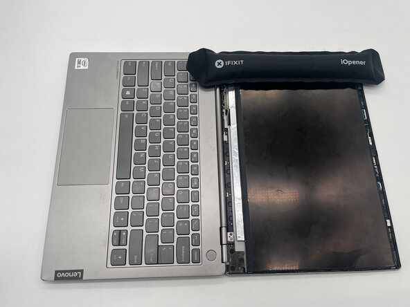

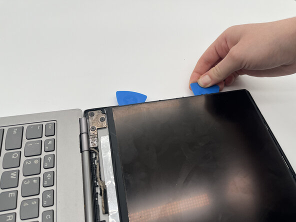

    1. Lenovo ThinkBook 13s-IML Screen Replacement, Screen: step 1, image 1 of 3 Lenovo ThinkBook 13s-IML Screen Replacement, Screen: step 1, image 2 of 3 Lenovo ThinkBook 13s-IML Screen Replacement, Screen: step 1, image 3 of 3
      • Use an opening tool to remove the bezel from around the screen.
      • Heat an iOpener and place it on the right and left sides of the screen to loosen the adhesive securing the screen.

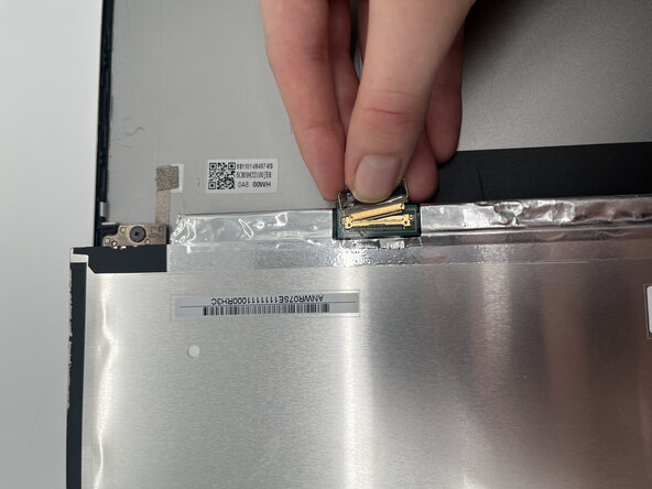

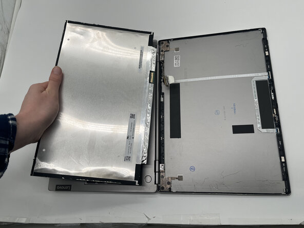

    2. Lenovo ThinkBook 13s-IML Screen Replacement: step 2, image 1 of 3 Lenovo ThinkBook 13s-IML Screen Replacement: step 2, image 2 of 3 Lenovo ThinkBook 13s-IML Screen Replacement: step 2, image 3 of 3
      • Carefully lift up the screen using the iFixit Opening Tool and the iFixit Opening Picks.
      • Carefully unlatch and remove the screen.
