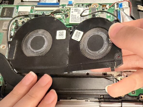

    1. Lenovo ThinkBook 13S-IML Motherboard Replacement, Fans: step 2, image 1 of 3 Lenovo ThinkBook 13S-IML Motherboard Replacement, Fans: step 2, image 2 of 3 Lenovo ThinkBook 13S-IML Motherboard Replacement, Fans: step 2, image 3 of 3
      • Detach the two sliding fan connectors from the system board by gently pulling them out of their sockets.
      • Use a screwdriver to unscrew the five 3.5 mm Phillips #00 screws that secure the fans in place.
      • Carefully lift the fans out of the system board.

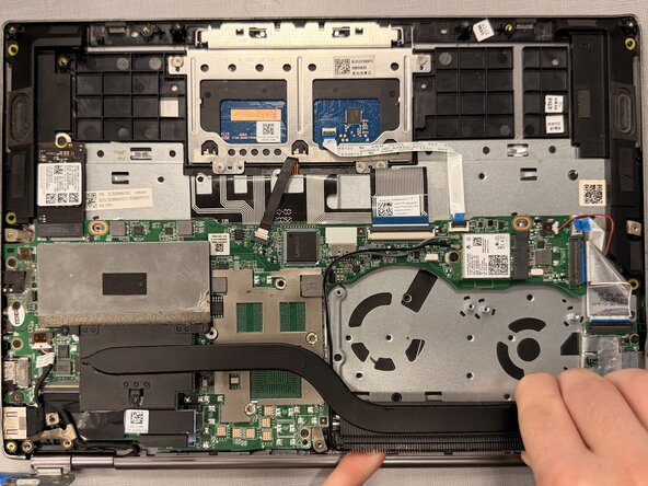

    1. Lenovo ThinkBook 13S-IML Motherboard Replacement, Motherboard: step 8, image 1 of 1
      • Remove the six M2.5 x 5mm Phillips #00 screws that secure the upper case hinges first.
      • Remove the two remaining M2 x 5mm Phillips #00 screws and set them aside.

    3. Lenovo ThinkBook 13S-IML Motherboard Replacement: step 10, image 1 of 2 Lenovo ThinkBook 13S-IML Motherboard Replacement: step 10, image 2 of 2
      • Remove all the following connectors before removing the screws from the motherboard:
      • ZIF connector.
      • Blue ribbon cable connector.
      • Sliding connector.
      • Remove the 5 4mm-long Phillips #00 screws holding down the motherboard.
      • It is easy to miss the screw below the black tape, remove this one first so you don't forget.
      Ask FixBot
    4. Lenovo ThinkBook 13S-IML Motherboard Replacement: step 11, image 1 of 2 Lenovo ThinkBook 13S-IML Motherboard Replacement: step 11, image 2 of 2
      • With all screws out, carefully remove the motherboard as shown, pulling toward the area of the power button (boxed in red).
