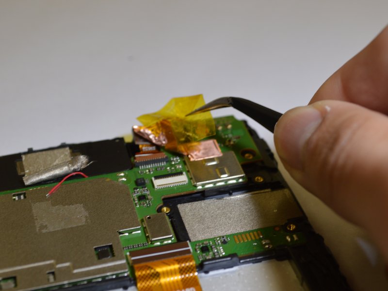

    1. Lenovo Tab 4 8 Front Camera Replacement, Front Camera: step 5, image 1 of 2 Lenovo Tab 4 8 Front Camera Replacement, Front Camera: step 5, image 2 of 2
      Tool used on this step:
      Buy
      • Using tweezers, lift the yellow tape hiding the front camera.
      • Disconnect the front camera's connector from the motherboard using tweezers.
      Ask FixBot
