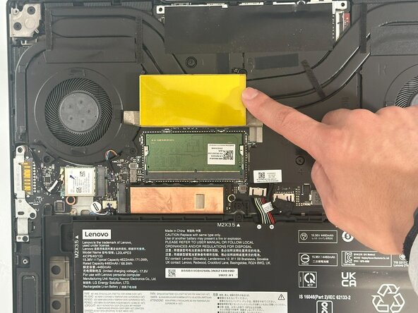

    6. Lenovo Legion 7 16ARHA7 RAM Replacement: step 6, image 1 of 1
      • Using a plastic spudger, press down in the area below where the arrow is indicated on the cover to release it.
      Ask FixBot

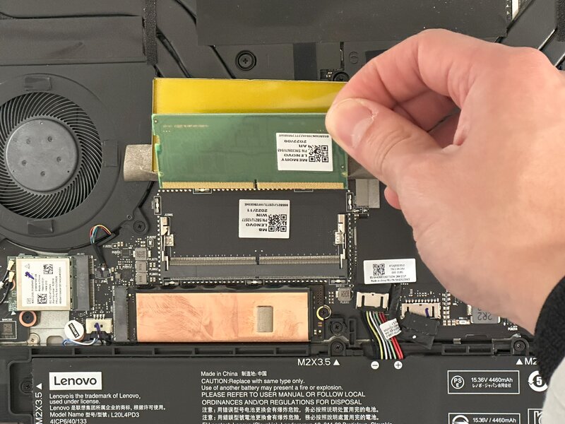

    7. Lenovo Legion 7 16ARHA7 RAM Replacement: step 7, image 1 of 1
      • Lift up the cover and peel back some of the tape to help it go fully back.
      Ask FixBot

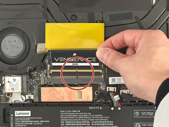

    9. Lenovo Legion 7 16ARHA7 RAM Replacement: step 9, image 1 of 1
      • Line up the empty slot on the new RAM stick with the empty slot on the connector and lightly insert it.
      • If the RAM stick slot does not line up with the connector, do not install. Otherwise you can damage your device or the part.
