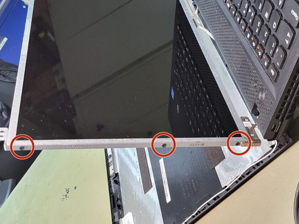

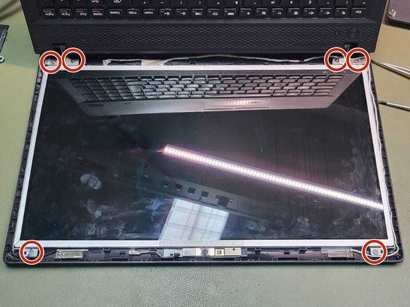

    3. Lenovo IdeaPad G500 screen replacement, More screws: step 5, image 1 of 2 Lenovo IdeaPad G500 screen replacement, More screws: step 5, image 2 of 2
      • Now you can carefully fold down the cover to access the back of the display and the sides.
      • Remove the six marked screws.
      • Be careful not to let the display fall down and/or fall out of the frame.
