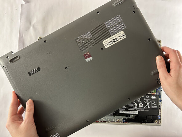

    2. Lenovo IdeaPad 320-15IKB RAM Replacement: step 2, image 1 of 3 Lenovo IdeaPad 320-15IKB RAM Replacement: step 2, image 2 of 3 Lenovo IdeaPad 320-15IKB RAM Replacement: step 2, image 3 of 3
      • Insert an opening tool into the seam between the lower case and chassis.
      • Pry around the entire perimeter until the lower case fully releases.
      • Remove the lower case.

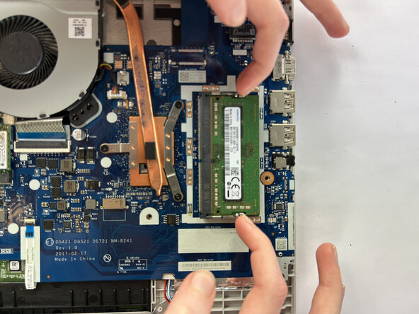

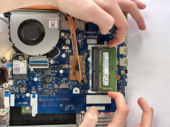

    1. Lenovo IdeaPad 320-15IKB RAM Replacement, RAM: step 4, image 1 of 3 Lenovo IdeaPad 320-15IKB RAM Replacement, RAM: step 4, image 2 of 3 Lenovo IdeaPad 320-15IKB RAM Replacement, RAM: step 4, image 3 of 3
      • Two clips secure the RAM module in place, one on each side. Using your fingers, spread the clips away from the RAM module.
      Ask FixBot
    2. Lenovo IdeaPad 320-15IKB RAM Replacement: step 5, image 1 of 2 Lenovo IdeaPad 320-15IKB RAM Replacement: step 5, image 2 of 2
      • Use light force to pull the RAM module directly out of its socket.
