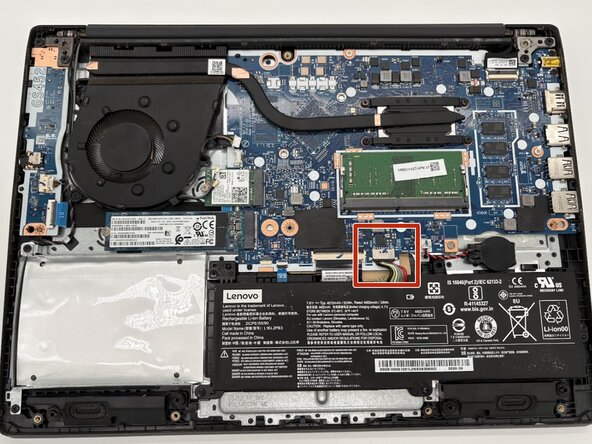

    2. Lenovo IdeaPad 3 14IML05 RAM Replacement: step 2, image 1 of 1
      • Use the point of a spudger to push on alternating sides of the battery connector to "walk" it out of its socket on the motherboard.
      • It may take a lot of alternating before the connector comes out. Be patient, and don't pull on the cables.
