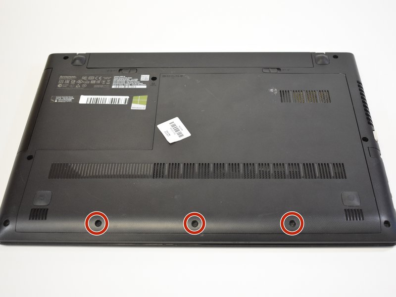

Many of the replacement guides for this model will be internal parts that are accessed by first removing the back access panel. Removing this part is very simple; the only tool needed is a small Philips screwdriver to remove three screws. Removing this part gives access necessary for future guides.
Tools
    1. Lenovo G50-70 Back Access Panel Replacement, Back Access Panel: step 1, image 1 of 2 Lenovo G50-70 Back Access Panel Replacement, Back Access Panel: step 1, image 2 of 2
      • Remove the three 6mm Phillips #0 screws holding the back access panel on.
      Ask FixBot
    2. Lenovo G50-70 Back Access Panel Replacement: step 2, image 1 of 2 Lenovo G50-70 Back Access Panel Replacement: step 2, image 2 of 2
      • Slide the cover toward you to unlatch it.
      • The edge of the panel will slide away from the laptop so it can be lifted.
