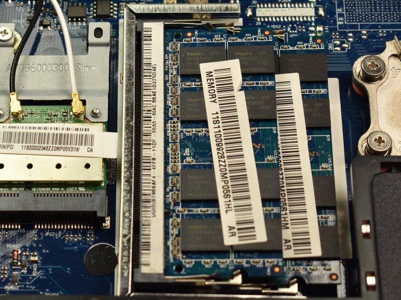

    1. Lenovo Essential G555-0873 RAM Replacement, RAM: step 3, image 1 of 3 Lenovo Essential G555-0873 RAM Replacement, RAM: step 3, image 2 of 3 Lenovo Essential G555-0873 RAM Replacement, RAM: step 3, image 3 of 3
      • Push apart hinges shown in picture until RAM pushes itself up to approximately a 30 degree angle.

    2. Lenovo Essential G555-0873 RAM Replacement: step 4, image 1 of 1
      • Pull the RAM stick out of its socket.
      Ask FixBot
    3. Lenovo Essential G555-0873 RAM Replacement: step 5, image 1 of 1
      • Push apart hinges of lower RAM stick until it pops up to a similar angle.
      Ask FixBot
    4. Lenovo Essential G555-0873 RAM Replacement: step 6, image 1 of 1
      • Pull out second RAM stick in the same way as the first.
      Ask FixBot
    5. Lenovo Essential G555-0873 RAM Replacement: step 7, image 1 of 2 Lenovo Essential G555-0873 RAM Replacement: step 7, image 2 of 2
      • Push RAM sticks in diagonally, then push down and snap it in with hinges.
