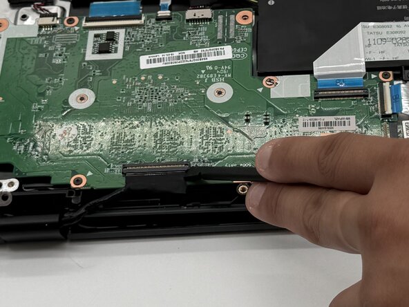

    1. Lenovo 500e Chromebook 81ES Display Assembly Replacement Guide, Display Assembly: step 3, image 1 of 3 Lenovo 500e Chromebook 81ES Display Assembly Replacement Guide, Display Assembly: step 3, image 2 of 3 Lenovo 500e Chromebook 81ES Display Assembly Replacement Guide, Display Assembly: step 3, image 3 of 3
      • Use a Phillips #0 screwdriver to remove the six 5 mm-long screws securing the two hinges.
      • Use tweezers to lift up the hinges.
      • Using a spudger, gently disconnect the display connector.
      Ask FixBot

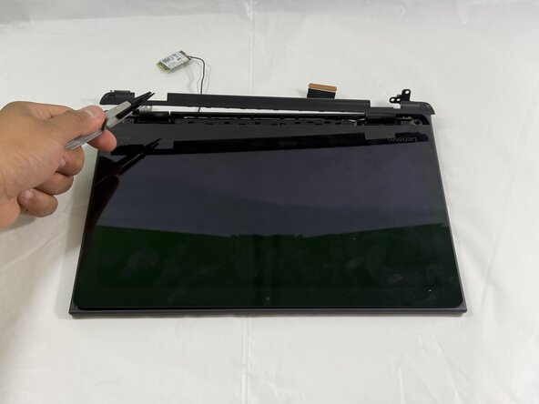

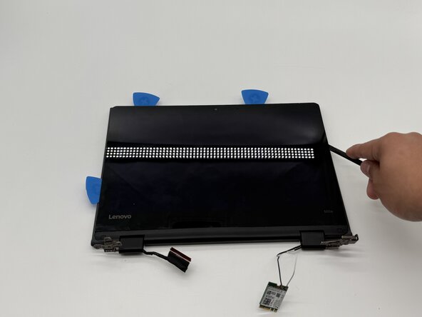

    4. Lenovo 500e Chromebook 81ES Display Assembly Replacement Guide: step 6, image 1 of 3 Lenovo 500e Chromebook 81ES Display Assembly Replacement Guide: step 6, image 2 of 3 Lenovo 500e Chromebook 81ES Display Assembly Replacement Guide: step 6, image 3 of 3
      • Remove the display assembly.
      • Insert the opening picks and spudger into the screen casing.
      • Remove the screen.
      Ask FixBot

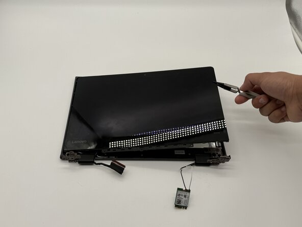

    5. Lenovo 500e Chromebook 81ES Display Assembly Replacement Guide: step 7, image 1 of 3 Lenovo 500e Chromebook 81ES Display Assembly Replacement Guide: step 7, image 2 of 3 Lenovo 500e Chromebook 81ES Display Assembly Replacement Guide: step 7, image 3 of 3
      • Slide the spudger into the center control cover.
      • Using tweezers, remove the cover.
      Ask FixBot

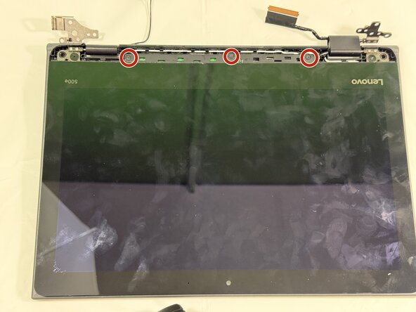

    7. Lenovo 500e Chromebook 81ES Display Assembly Replacement Guide: step 9, image 1 of 3 Lenovo 500e Chromebook 81ES Display Assembly Replacement Guide: step 9, image 2 of 3 Lenovo 500e Chromebook 81ES Display Assembly Replacement Guide: step 9, image 3 of 3
      • Use a Phillips #0 screwdriver to remove the three 3 mm-long screws on the top holding the display hinge metal bracket.
      • Use a Phillips #0 screwdriver to remove the two 2 mm-long screws on the bottom of the metal bracket.
      Ask FixBot
