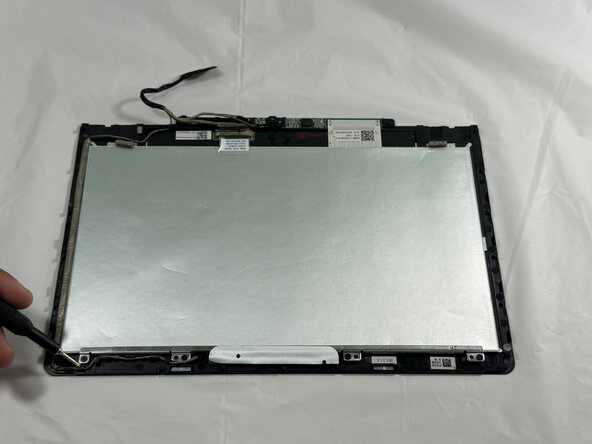

    6. Lenovo 500e Chromebook 81ES Camera Replacement: step 6, image 1 of 2 Lenovo 500e Chromebook 81ES Camera Replacement: step 6, image 2 of 2
      • Use a Phillips #0 screwdriver to remove the three 2 mm-long screws securing the screen.
      Ask FixBot

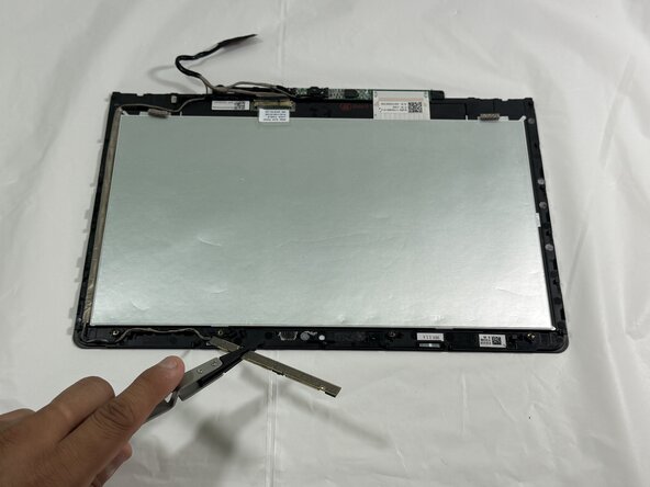

    7. Lenovo 500e Chromebook 81ES Camera Replacement: step 7, image 1 of 3 Lenovo 500e Chromebook 81ES Camera Replacement: step 7, image 2 of 3 Lenovo 500e Chromebook 81ES Camera Replacement: step 7, image 3 of 3
      • Use a Phillips #0 screwdriver to remove the three 3 mm-long screws on the top holding the display hinge metal bracket.
      • Use a Phillips #0 screwdriver to remove the two 2 mm-long screws on the bottom of the metal bracket.
      Ask FixBot
    8. Lenovo 500e Chromebook 81ES Camera Replacement: step 8, image 1 of 2 Lenovo 500e Chromebook 81ES Camera Replacement: step 8, image 2 of 2
      • Use tweezers to remove the metal bracket.
      • Using tweezers, gently pull the main cables attached to the sensor board.
