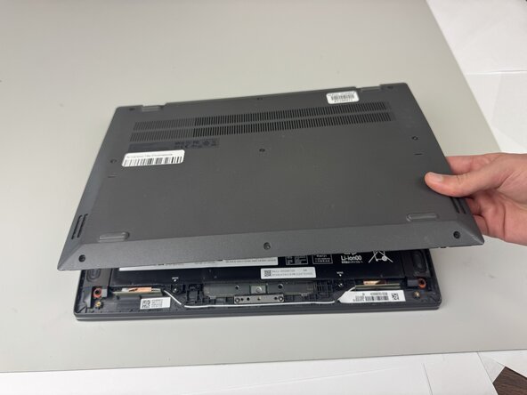

      • Use a Phillips #0 screwdriver to remove the nine 8.6 mm screws from the back cover.
      Ask FixBot
    2. Lenovo 14e Chromebook Touchpad Replacement: step 2, image 1 of 2 Lenovo 14e Chromebook Touchpad Replacement: step 2, image 2 of 2
      • Carefully remove the back cover from the Chromebook.
      • You may hear clicking sounds as the cover becomes detached from the frame.
      Ask FixBot

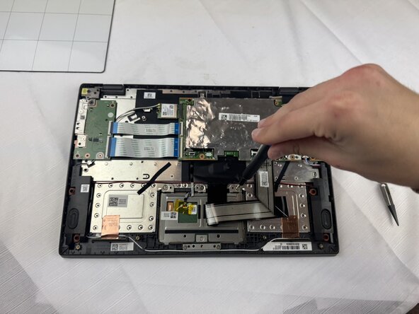

    1. Lenovo 14e Chromebook Touchpad Replacement, Touchpad: step 5, image 1 of 2 Lenovo 14e Chromebook Touchpad Replacement, Touchpad: step 5, image 2 of 2
      • Use a Phillips #0 screwdriver to remove the five 5.5mm screws holding the touchpad in place.
      Ask FixBot
    2. Lenovo 14e Chromebook Touchpad Replacement: step 6, image 1 of 2 Lenovo 14e Chromebook Touchpad Replacement: step 6, image 2 of 2
      • Use tweezers to gently grasp and disconnect the touchpad ribbon cable.
      Ask FixBot
    3. Lenovo 14e Chromebook Touchpad Replacement: step 7, image 1 of 3 Lenovo 14e Chromebook Touchpad Replacement: step 7, image 2 of 3 Lenovo 14e Chromebook Touchpad Replacement: step 7, image 3 of 3
      • Remove the frame holding the touchpad in place.
      • Gently lift the touchpad from the Chromebook, and remove it.
