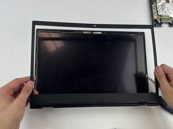

    1. Lenovo 14e Chromebook Front Facing Camera Replacement, Front Facing Camera: step 1, image 1 of 1
      • Use a Jimmy to pry open the seal between the bezel and the screen.
      Ask FixBot
    2. Lenovo 14e Chromebook Front Facing Camera Replacement: step 2, image 1 of 1
      • Continue sliding the Jimmy around the entire bezel to remove it from the screen.
      • You will hear clicking sounds as the bezel detaches from the screen.
      Ask FixBot
    3. Lenovo 14e Chromebook Front Facing Camera Replacement: step 3, image 1 of 1
      • Carefully remove the bezel from the Chromebook.
      Ask FixBot

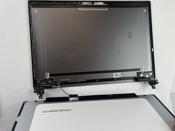

    10. Lenovo 14e Chromebook Front Facing Camera Replacement: step 10, image 1 of 1
      • Lift up the yellow tape and remove the screen.
      Ask FixBot
    11. Lenovo 14e Chromebook Front Facing Camera Replacement: step 11, image 1 of 1
      • Lay the screen face down on the table.
      • There is no need to remove the wire attaching the screen to the frame.

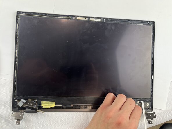

    12. Lenovo 14e Chromebook Front Facing Camera Replacement: step 12, image 1 of 1
      • Using a metal spudger, pry off the front facing camera.
      Ask FixBot
    13. Lenovo 14e Chromebook Front Facing Camera Replacement: step 13, image 1 of 1
      • Lift the camera out.
      Ask FixBot
