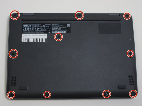

    2. Lenovo 100e Chromebook Gen 4 Screen Replacement: step 2, image 1 of 2 Lenovo 100e Chromebook Gen 4 Screen Replacement: step 2, image 2 of 2
      • Remove ten 7mm screws with a Phillips #0 screwdriver.
      Ask FixBot

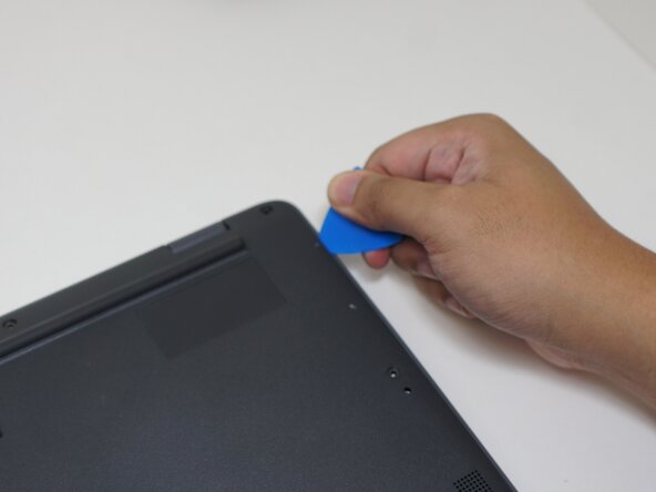

    3. Lenovo 100e Chromebook Gen 4 Screen Replacement: step 3, image 1 of 2 Lenovo 100e Chromebook Gen 4 Screen Replacement: step 3, image 2 of 2
      • Use an opening pick to wedge the upper right corner of the bottom cover.
      • Use a spudger to pry open the rest of the cover.

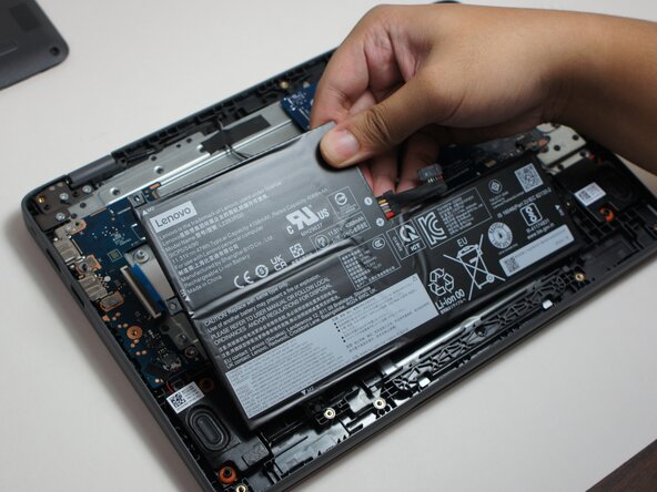

    4. Lenovo 100e Chromebook Gen 4 Screen Replacement: step 4, image 1 of 2 Lenovo 100e Chromebook Gen 4 Screen Replacement: step 4, image 2 of 2
      • Use the flat end of the spudger to push the battery cable out.
      • The connectors for every cable in this laptop are delicate. Apply a gentle amount of force when disconnecting or unlatching any cables.
      Ask FixBot
    5. Lenovo 100e Chromebook Gen 4 Screen Replacement: step 5, image 1 of 2 Lenovo 100e Chromebook Gen 4 Screen Replacement: step 5, image 2 of 2
      • Remove four 4mm screws with a Phillips #0 screwdriver.
      Ask FixBot
    6. Lenovo 100e Chromebook Gen 4 Screen Replacement: step 6, image 1 of 1
      • Remove the battery by putting your finger under the battery and pulling towards you.
      Ask FixBot

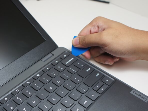

    1. Lenovo 100e Chromebook Gen 4 Screen Replacement, Keyboard: step 7, image 1 of 2 Lenovo 100e Chromebook Gen 4 Screen Replacement, Keyboard: step 7, image 2 of 2
      • Use an opening pick to wedge under the keyboard and create an opening.
      • Use a spudger to pry under and all around the keyboard.
      • After prying, lift up the keyboard.
      Ask FixBot

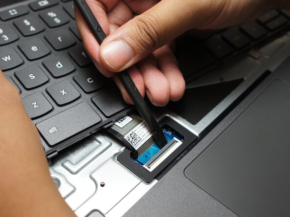

    2. Lenovo 100e Chromebook Gen 4 Screen Replacement: step 8, image 1 of 3 Lenovo 100e Chromebook Gen 4 Screen Replacement: step 8, image 2 of 3 Lenovo 100e Chromebook Gen 4 Screen Replacement: step 8, image 3 of 3
      • Use tweezers to peel off the tape on the keyboard cable.
      • Use a spudger to unlatch the keyboard cable.
      • Disconnect the keyboard cable by lifting it up and out.
      Ask FixBot

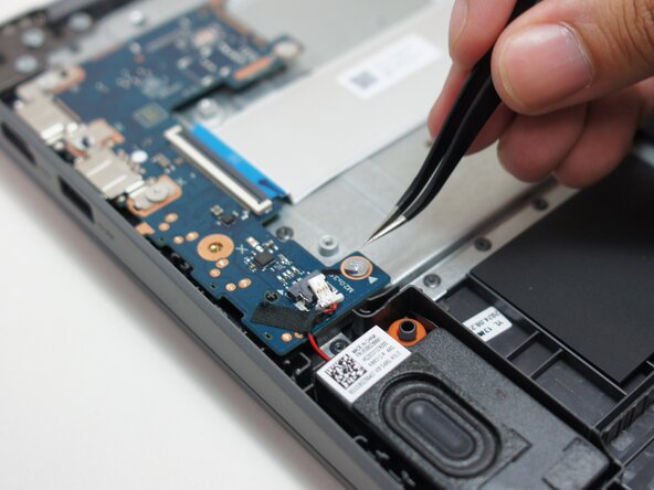

    1. Lenovo 100e Chromebook Gen 4 Screen Replacement, Speakers: step 14, image 1 of 2 Lenovo 100e Chromebook Gen 4 Screen Replacement, Speakers: step 14, image 2 of 2
      • Use tweezers to pull the left speaker cable out of the USB board.
      Ask FixBot

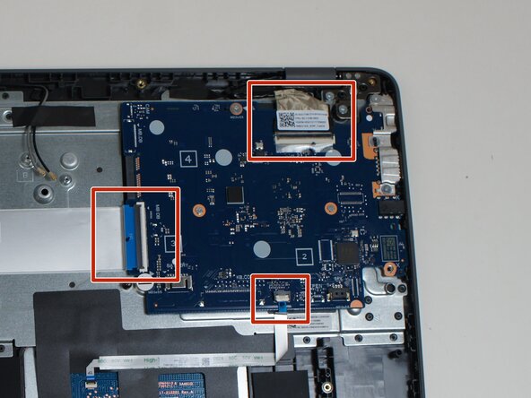

    1. Lenovo 100e Chromebook Gen 4 Screen Replacement, Motherboard: step 18, image 1 of 1
      • Locate these three wires on the main board.
      • These wires must be removed before taking the main board out of the laptop.
      Ask FixBot
    2. Lenovo 100e Chromebook Gen 4 Screen Replacement: step 19, image 1 of 3 Lenovo 100e Chromebook Gen 4 Screen Replacement: step 19, image 2 of 3 Lenovo 100e Chromebook Gen 4 Screen Replacement: step 19, image 3 of 3
      • Disconnect all the cables from the main board.
      • All cables rely on a clasp to keep them in place.
      • Flip the clasp up with the plastic spudger before lightly pulling back on each wire to free it.
      Ask FixBot

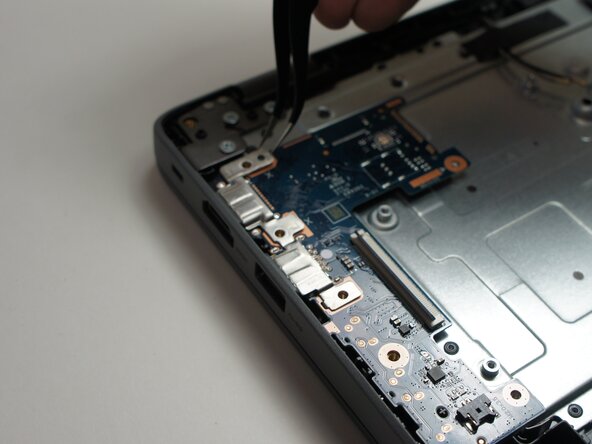

    1. Lenovo 100e Chromebook Gen 4 Screen Replacement, USB Board: step 23, image 1 of 2 Lenovo 100e Chromebook Gen 4 Screen Replacement, USB Board: step 23, image 2 of 2
      • Unlatch the cable clasp with a spudger.
      • Remove the cable by pulling it out of the connector, using a pair of tweezers. You can use your fingers as well.

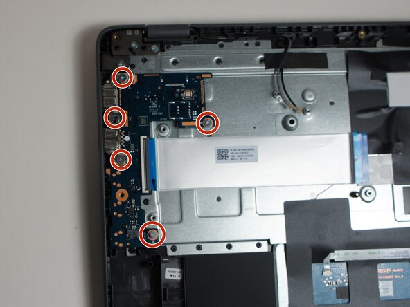

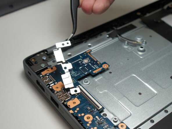

    2. Lenovo 100e Chromebook Gen 4 Screen Replacement: step 24, image 1 of 2 Lenovo 100e Chromebook Gen 4 Screen Replacement: step 24, image 2 of 2
      • Remove five 4mm screws with a Phillips #0 screwdriver.
      Ask FixBot
    3. Lenovo 100e Chromebook Gen 4 Screen Replacement: step 25, image 1 of 2 Lenovo 100e Chromebook Gen 4 Screen Replacement: step 25, image 2 of 2
      • Use a pair of tweezers to remove the bracket by lifting it out of the Chromebook.
      Ask FixBot
    4. Lenovo 100e Chromebook Gen 4 Screen Replacement: step 26, image 1 of 2 Lenovo 100e Chromebook Gen 4 Screen Replacement: step 26, image 2 of 2
      • Remove the USB Board by lifting it out of the Chromebook.
      Ask FixBot

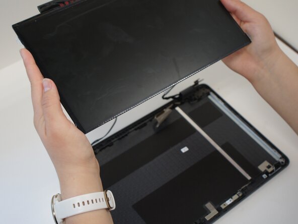

    5. Lenovo 100e Chromebook Gen 4 Screen Replacement: step 31, image 1 of 2 Lenovo 100e Chromebook Gen 4 Screen Replacement: step 31, image 2 of 2
      • Lift the screen and turn it over.
      Ask FixBot

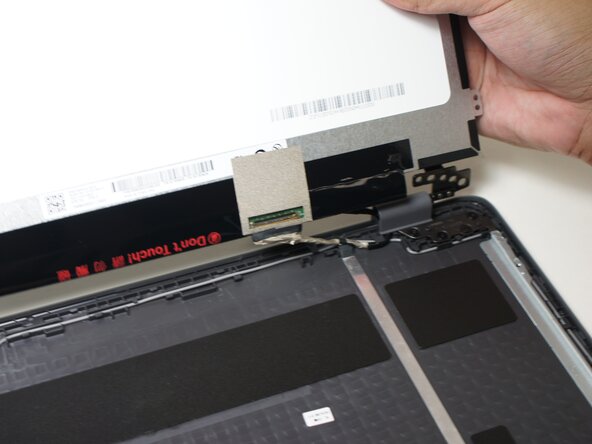

    6. Lenovo 100e Chromebook Gen 4 Screen Replacement: step 32, image 1 of 2 Lenovo 100e Chromebook Gen 4 Screen Replacement: step 32, image 2 of 2
      • Use a pair of tweezers to remove the tape covering the EDP cable.
      • The EDP Cable is the Embedded DisplayPort Cable, which allows the screen to connect to the main board.
      Ask FixBot
    7. Lenovo 100e Chromebook Gen 4 Screen Replacement: step 33, image 1 of 2 Lenovo 100e Chromebook Gen 4 Screen Replacement: step 33, image 2 of 2
      • Use a pair of tweezers to unlatch the clasp covering the EDP cable.
      • Use the tweezers to remove the EDP cable by pulling it out.
      Ask FixBot
    8. Lenovo 100e Chromebook Gen 4 Screen Replacement: step 34, image 1 of 1
      • Remove the screen by lifting it straight up.
      Ask FixBot
