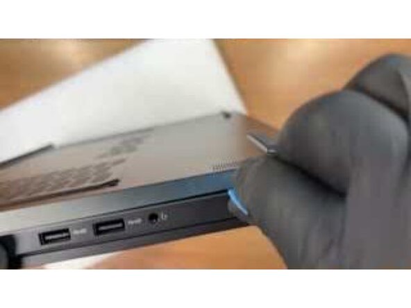

    2. Legion Legion Pro 7 16IAX10H Repaste, Release the bottom cover: step 2, image 1 of 3 Legion Legion Pro 7 16IAX10H Repaste, Release the bottom cover: step 2, image 2 of 3 Legion Legion Pro 7 16IAX10H Repaste, Release the bottom cover: step 2, image 3 of 3
      • Insert an opening pick into the gap between the bottom cover and the housing along the left edge.
      • Slide the opening pick along the edge to release the clips.
      • Continue to release the clips in the hinge area, along the front edge, and along the right edge of the housing.
      • Work slowly and do not bend the bottom cover.
      • A second opening pick can prevent already released clips from snapping back into place.

    3. Legion Legion Pro 7 16IAX10H Repaste, Remove the bottom cover: step 3, image 1 of 1
      • Lift the loosened bottom cover from the housing.

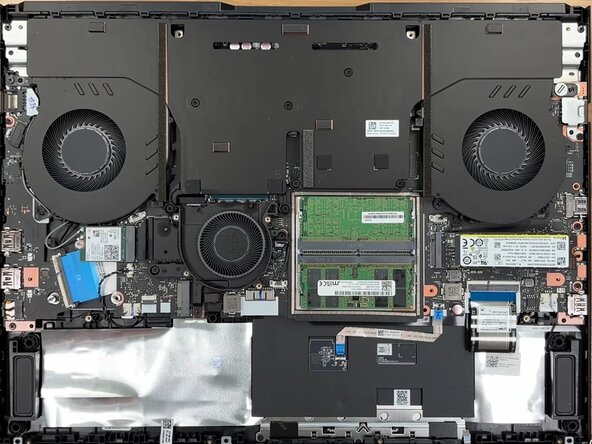

    6. Legion Legion Pro 7 16IAX10H Repaste, Removing the RAM and SSD cover: step 6, image 1 of 2 Legion Legion Pro 7 16IAX10H Repaste, Removing the RAM and SSD cover: step 6, image 2 of 2
      • Use a JIS #00 screwdriver to remove the four small screws securing the cover to the center cooling fan.
      • Loosen the seven numbered captive screws in order from 1 to 7.
      • When reassembling, tighten the numbered screws in reverse order and in two passes.
      • Release the cover from the two alignment pins and lift it off.
      Ask FixBot
    1. Legion Legion Pro 7 16IAX10H Repaste, Thermal Paste PTM: step 7, image 1 of 2 Legion Legion Pro 7 16IAX10H Repaste, Thermal Paste PTM: step 7, image 2 of 2

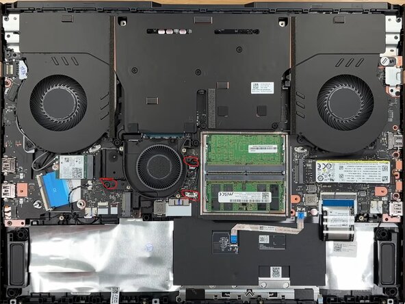

      • From this point on, it is very important that the battery is unplugged, or even better, completely removed, in order to prevent any potential short circuits and damage during the work as much as possible!!!
      • Next, we remove the chipset heat sink, which also cools two GPU VRAMs, by removing the marked screws and unplugging the power connector for the cooling fan. This would otherwise be the official Lenovo guide for removing the heat sink: https://support.lenovo.com/ch/de/documen...
      • The cooling fan can now be removed.
      Ask FixBot

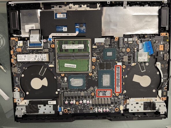

    3. Legion Legion Pro 7 16IAX10H Repaste: step 9, image 1 of 1
      • Once the heat sink is removed, everything must be cleaned. Thermal pads can potentially be reused. However, the VRAM of the GPU as well as the GPU and CPU die must be cleaned with isopropyl alcohol. The same applies to the heat sink. Clean everything thoroughly there as well.
      • It is best to work with cotton swabs and clean everything thoroughly; avoid touching surfaces with your fingers or wear gloves.
      • After cleaning, a small bead of thermal putty can be applied to each of the marked VRAM modules. Spread it slightly with the scraper. Not too much and not too little.
      • Then, cut the PTM7950 or Thermal Grizzly phase sheet PTM to size for the CPU and apply it. Tip: cut it to size, peel off the protective film on the first side of the PTM, then position the PTM on the CPU die and press it down. Then wait for 1 minute so that the PTM cools down from your fingers. This makes it easier to remove the second protective film.
      • Perform the same procedure for the GPU.
      • Then, perform a final check to ensure that no thermal pad has fallen off the heat sink on the voltage regulator modules (VRM) or the MOSFETs, and then reattach the heat sink.
      • Proceed carefully, position the heat sink in the air, and only lower and press it down at the very end. Then, re-tighten the screws in the reverse order of how you removed them.
      • First, the two outer screws. One of them has a Lenovo sticker on it. Then, tighten the screws according to the numbering 1-7. Tighten them slowly and only a little at a time. Perform 2 passes for tightening and 1 check pass to ensure everything is seated.
