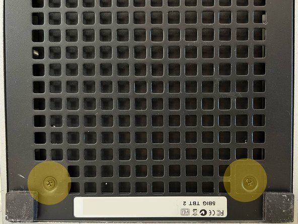

  3. Lacie 5big Network/Thunderbolt 2 Disassembly, Unscrew cover: step 3, image 1 of 3 Lacie 5big Network/Thunderbolt 2 Disassembly, Unscrew cover: step 3, image 2 of 3 Lacie 5big Network/Thunderbolt 2 Disassembly, Unscrew cover: step 3, image 3 of 3
    • The structure is held in place by 4 screws and some friction.
    • With the drives removed, peer inside to see the two screws at the bottom of the cage. Unscrew those. You might need an extender for these two.
    • Next, put the structure upside down and take off the 2 feet at the front of the cage (the side with the blue dot).
    • You'll find two screws under there, unscrew those too.
    Ask FixBot
