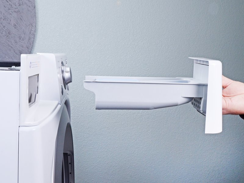

    1. LG WM3050CW Detergent Drawer Replacement, Remove the detergent drawer: step 1, image 1 of 2 LG WM3050CW Detergent Drawer Replacement, Remove the detergent drawer: step 1, image 2 of 2
      • Pull the detergent drawer away from the chassis as far as it will go.
      Ask FixBot
    2. LG WM3050CW Detergent Drawer Replacement: step 2, image 1 of 3 LG WM3050CW Detergent Drawer Replacement: step 2, image 2 of 3 LG WM3050CW Detergent Drawer Replacement: step 2, image 3 of 3
      • Press down on the "Push" button to disengage the clips securing the detergent drawer.
      • Pull the drawer out of its slot on the chassis and remove it.
