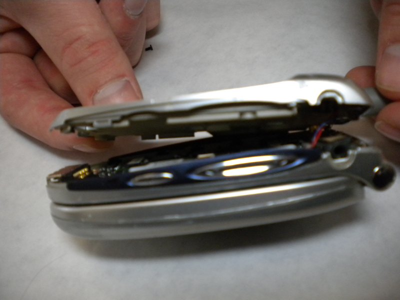

    3. LG VX6000 Body Replacement: step 5, image 1 of 1
      • Carefully remove the back of the phone with your fingernails or tweezers.
      • There are red and blue wires connected to the motherboard. Forcing the components apart could damage the wires.
      • The red and blue wires must be plugged in to reassemble.
      Ask FixBot
