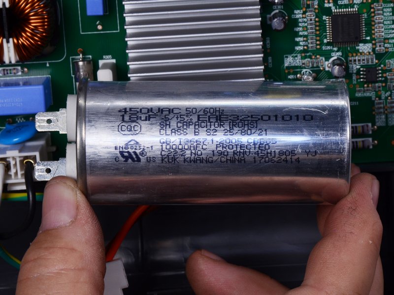

Use this guide to replace the compressor run capacitor in your LG refrigerator.
This guide will work for most LG refrigerators. This guide is written with an LG model LFX25973 refrigerator. If you have a different model, you may encounter some minor disassembly differences, but the overall repair process will be the same.
The compressor run capacitor is needed for the compressor to run properly. If it fails, your compressor may not run or will run poorly.
If you are experiencing poor cooling or the compressor isn't functioning, the run capacitor is one of the items to check. There may not be an error code associated with this condition.

    1. LG Refrigerator Compressor Run Capacitor Replacement, Unclip the capacitor: step 4, image 1 of 3 LG Refrigerator Compressor Run Capacitor Replacement, Unclip the capacitor: step 4, image 2 of 3 LG Refrigerator Compressor Run Capacitor Replacement, Unclip the capacitor: step 4, image 3 of 3
      • Pull the left edge of the capacitor toward you to unclip it.
      • Handle the capacitor carefully as it may still be charged, and can give a dangerous and painful electrical shock. Avoid touching the terminals with your fingers or hands.
      • For information on capacitor safety, click here.
      Ask FixBot
    2. LG Refrigerator Compressor Run Capacitor Replacement, Disconnect the capacitor: step 5, image 1 of 3 LG Refrigerator Compressor Run Capacitor Replacement, Disconnect the capacitor: step 5, image 2 of 3 LG Refrigerator Compressor Run Capacitor Replacement, Disconnect the capacitor: step 5, image 3 of 3
      • Pull the connector straight off the capacitor to disconnect it.
      • Remove the capacitor.
      Ask FixBot
