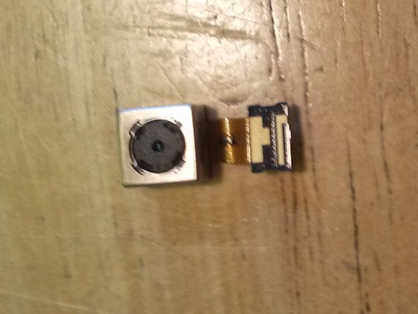

  4. LG Optimus F3 digitizer screen glass replacement: step 4, image 1 of 2 LG Optimus F3 digitizer screen glass replacement: step 4, image 2 of 2
    • Use pry tool to disconnect camera cable and then remove the camera
