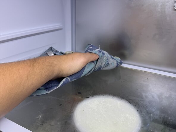

      • Wipe up any water that dripped during the replacement.

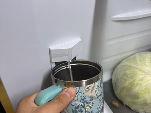

      • Dispense about half a gallon of water to flush the new filter and remove trapped air.
