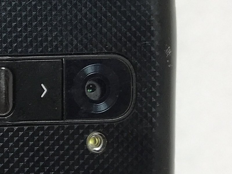

    1. LG G2 Sprint Rear Facing Camera Replacement, Rear Camera: step 8, image 1 of 1
      • The rear facing camera is attached to the phone case with adhesive. Make sure to use your plastic prying tool to softly remove the camera from the case.
      • Only use a plastic or ESD safe tool when removing components such as the camera.
