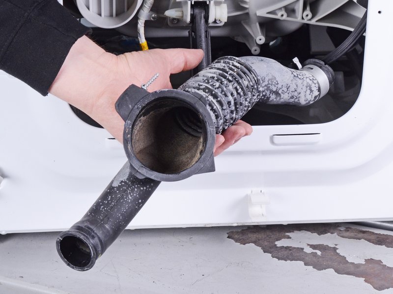

    1. LG Front Load Washing Machine Pump Hose Replacement, Loosen the pump hose: step 35, image 1 of 2 LG Front Load Washing Machine Pump Hose Replacement, Loosen the pump hose: step 35, image 2 of 2
      • Use a Phillips driver to loosen the pump hose from the drum enough to disconnect it.
      Ask FixBot
    2. LG Front Load Washing Machine Pump Hose Replacement, Disconnect the pump hose: step 36, image 1 of 2 LG Front Load Washing Machine Pump Hose Replacement, Disconnect the pump hose: step 36, image 2 of 2
      • Pull the pump hose straight off the drum to disconnect it.
      Ask FixBot
    3. LG Front Load Washing Machine Pump Hose Replacement, Remove the pump hose: step 37, image 1 of 1
      • Remove the pump hose.
      • During reassembly, use liquid laundry detergent to lubricate the hose around its tub connection.
      Ask FixBot
