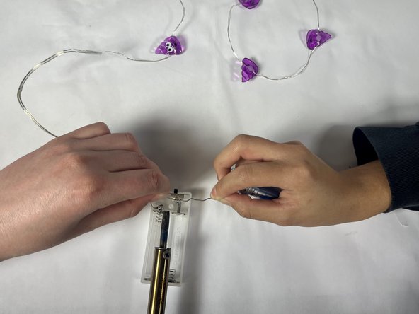

      • Leave the batteries in the pack and switch the light on.
      • Hold the disconnected wires to the terminals and try to reconnect the circuit.
      • If it isn’t turning on, try switching the wires.
      • Mark one of the wires to differentiate them.

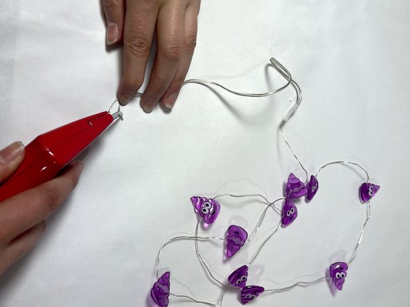

      • Cut off the frayed ends of each wire with pliers.
      Ask FixBot
    4. LED Fairy Lights Wire Repair: step 4, image 1 of 1
      • Using a box cutter or wire stripper, strip about ¼ inch of the insulation off each wire's end.
      Ask FixBot
    5. LED Fairy Lights Wire Repair: step 5, image 1 of 1
      • Twist the end of each wire to prepare it for tinning.

    7. LED Fairy Lights Wire Repair: step 7, image 1 of 1
      • Hold the solder to the wire to melt it, and apply a small bead to the end of the wire.
      • Repeat for the second wire.
      • Wait for the solder to completely cool.

    9. LED Fairy Lights Wire Repair: step 9, image 1 of 1
      • Place the wire where you will be soldering it, and use the soldering iron to melt the solder to connect the wire to the battery terminal. Repeat for the second wire.
      • Having another person with you to help hold the wire is helpful!
      • Make sure you know which wire should be connected where. You should repeat the test in Step 1.
