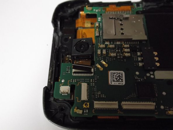

    7. Kyocera Hydro Life Rear-Facing Camera Replacement: step 7, image 1 of 2 Kyocera Hydro Life Rear-Facing Camera Replacement: step 7, image 2 of 2
      • Using a plastic prying tool, gently loosen all 4 corners of the motherboard.
      • Lift the motherboard away from the phone enclosure.

    9. Kyocera Hydro Life Rear-Facing Camera Replacement: step 9, image 1 of 1
      • Remove the camera from the motherboard.
      • This step requires breaking metal.
      • Only cut along the camera square.
