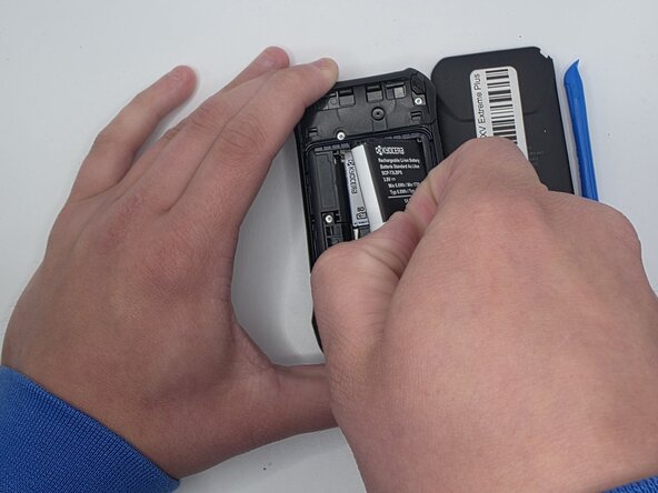

    2. Kyocera DuraXV Extreme Plus Back Camera Lens Replacement: step 2, image 1 of 3 Kyocera DuraXV Extreme Plus Back Camera Lens Replacement: step 2, image 2 of 3 Kyocera DuraXV Extreme Plus Back Camera Lens Replacement: step 2, image 3 of 3
      • Grip the edge of the white pull tab on the battery.
      • Gently pull the white pull tab to remove the battery.
