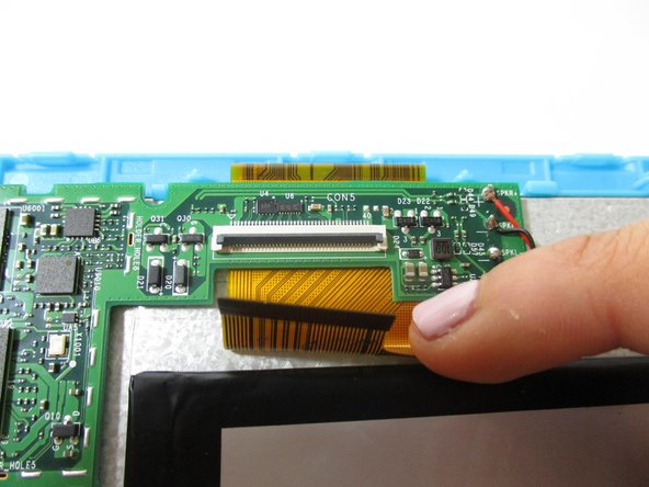

    2. Kurio Xtreme Motherboard Replacement: step 5, image 1 of 2 Kurio Xtreme Motherboard Replacement: step 5, image 2 of 2
      • Remove the orange data display ribbon wire above the battery by prying open the ZIF connector with the plastic opening tool.
