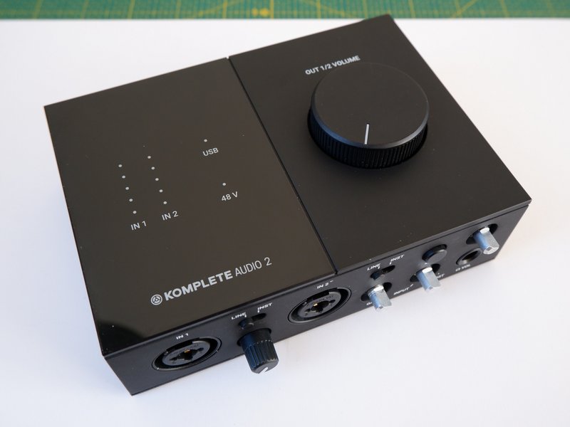

Is your interface disconnecting constantly or not recognized at all? Use this guide to replace a damaged USB port on your Native Instruments Komplete Audio 2.
  • This repair involves soldering components on the PCB.
  • Since they share a very similar internal chassis design, this guide may also be helpful for repairs on
    • Komplete Audio 1

    1. Komplete Audio 2 USB Port Replacement, Bottom cover screws: step 1, image 1 of 3 Komplete Audio 2 USB Port Replacement, Bottom cover screws: step 1, image 2 of 3 Komplete Audio 2 USB Port Replacement, Bottom cover screws: step 1, image 3 of 3
      • The bottom cover is secured by six screws. We will remove them in this step.
      • The center screw is concealed behind the product label. You may need to pierce or peel back the label to access it.
      • Place the device upside down.
      • Use a Phillips #1 screwdriver to remove the six screws from the bottom cover.
