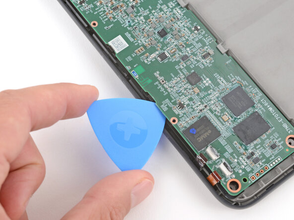

    2. Kobo Libra Colour (N428B) Screen Replacement, Disconnect the battery: step 8, image 1 of 2 Kobo Libra Colour (N428B) Screen Replacement, Disconnect the battery: step 8, image 2 of 2
      • Use a spudger to pry up and disconnect the battery press connector.
      • Don't pry against the motherboard, as you risk breaking small, surface-mounted components.
      • Your E-ink screen will continue to say Powered off even after disconnection—this is normal!

    1. Kobo Libra Colour (N428B) Screen Replacement, Soften the ZIF connector coating: step 9, image 1 of 2 Kobo Libra Colour (N428B) Screen Replacement, Soften the ZIF connector coating: step 9, image 2 of 2
      • Heat an iOpener and lay it on the power button ZIF connector (near the top right corner of the motherboard) for 90 seconds to soften the coating.
      • Alternatively, you can use a hair dryer or heat gun for 30 seconds to soften the coating.

    2. Kobo Libra Colour (N428B) Screen Replacement, Remove the coating: step 10, image 1 of 3 Kobo Libra Colour (N428B) Screen Replacement, Remove the coating: step 10, image 2 of 3 Kobo Libra Colour (N428B) Screen Replacement, Remove the coating: step 10, image 3 of 3
      • Use the tip of a spudger and pointed tweezers to scrape and remove the coating from the ZIF connector's locking tab and cable.
      • If the coating becomes too brittle and hard to peel off, reheat the power button board and try again.
      • This is a meticulous process! Failure to remove enough of the coating could damage the locking tab during disconnection, so take your time!

    2. Kobo Libra Colour (N428B) Screen Replacement, Unclip the motherboardRemove the motherboard: step 31, image 1 of 3 Kobo Libra Colour (N428B) Screen Replacement, Unclip the motherboardRemove the motherboard: step 31, image 2 of 3 Kobo Libra Colour (N428B) Screen Replacement, Unclip the motherboardRemove the motherboard: step 31, image 3 of 3
      • Four tabs secure the motherboard in place—two plastic ones on the outer edge, and two metal ones near the battery.
      • Be very careful not to damage any of the small, surface‑mounted components on the motherboard during this step.
      • Insert the tip of an opening pick betwen the motherboard and the plastic buffer beneath it, near one of the plastic clips on the outer edge.
      • Gently twist the pick to release the clip.
      • Repeat the process to release the other plastic clip.
      • During reassembly, gently press down near the center of the board's outer edge to engage the two plastic clips.
      Ask FixBot
