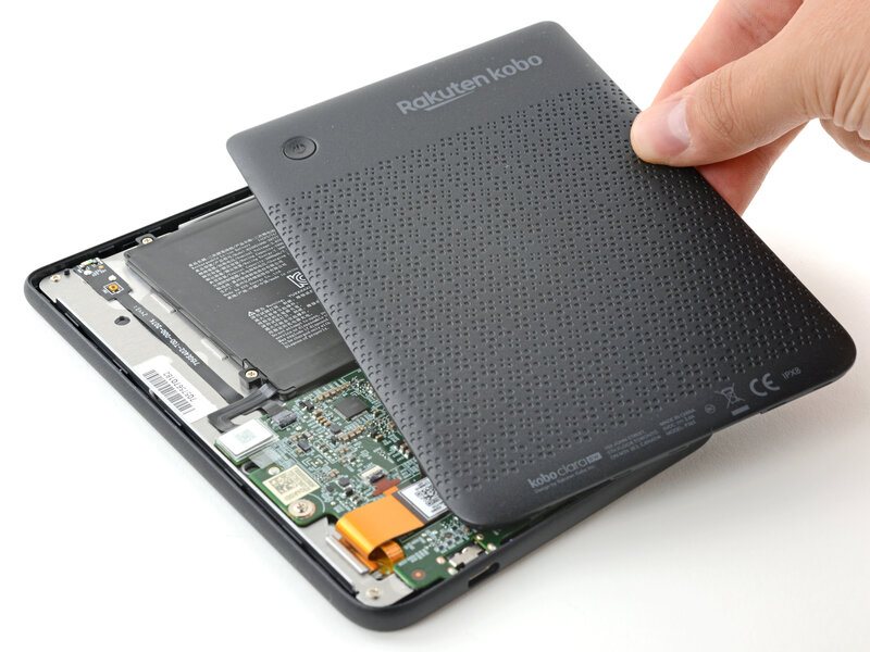

    5. Kobo Clara Colour (N367B) Back Cover Replacement, Remove the back cover: step 6, image 1 of 3 Kobo Clara Colour (N367B) Back Cover Replacement, Remove the back cover: step 6, image 2 of 3 Kobo Clara Colour (N367B) Back Cover Replacement, Remove the back cover: step 6, image 3 of 3
      • At this point, you should be able to grip the back cover and release its remaining clips. If not, slide a pick under the perimeter of the back cover until you can grip an edge.
      • Grip the left edge of the back cover and lift it away from the eReader to release the remaining clips.
      • Remove the back cover.
      • During reassembly, align the back cover over the eReader and press along the perimeter until all its clips snap back into place.
