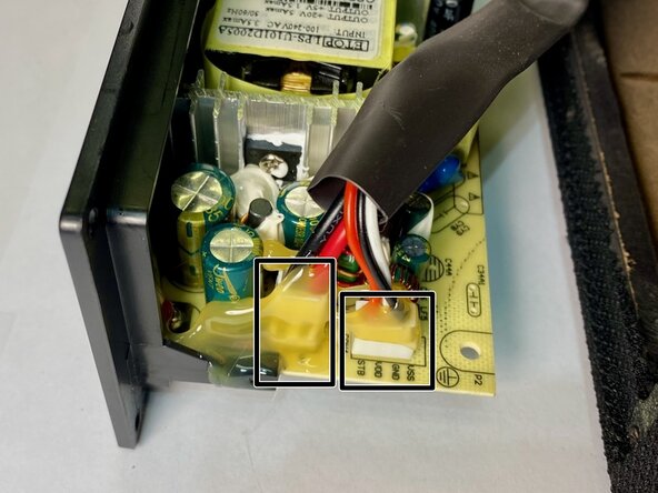

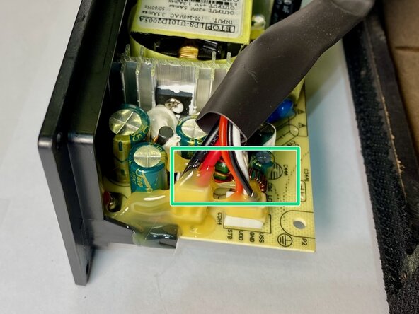

    4. Klipsch Cinema 600 Power Supply Module Replacement, Identify the Wiring Configuration: step 4, image 1 of 1
      • Locate the original green-bottom / yellow-top factory power supply board
      • Inspect the printed text labels directly on the board to confirm your specific version layout:
      • Version 1 (shown): `STB` = Red | `VDD` = White | `GND` = Black
      • Version 2: `STB` = Red | `VDD` = Black | `GND` = White
      • Klipsch Factory wiring typically consists of a thick red wire (24V+), thick black wire (24V-), thin red wire (STB), thin white wire (VDD), and thin black wire (GND). The thin black and thin white wires can be wired differently. The original power supply labeling is the authority.

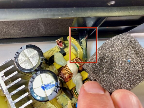

    5. Klipsch Cinema 600 Power Supply Module Replacement, Remove the Failed Power Supply: step 5, image 1 of 2 Klipsch Cinema 600 Power Supply Module Replacement, Remove the Failed Power Supply: step 5, image 2 of 2
      • You do not need to clean all factory glue off the loose wires, but you must clear the glue from the plastic chassis bracket arms inside the back cover so the new adapter fits properly
      • Apply isopropyl alcohol (90% or higher) to soften the factory glue holding the wire connections and the board bracket arms, then scrape it away using a plastic spudger.
      • Red square shows bracket arm being cleaned of glue.
      • Once the plastic bracket arms are completely clear of adhesive, gently slide the failed power supply board out of its slots. Preserve the structural integrity of these arms.

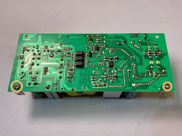

    6. Klipsch Cinema 600 Power Supply Module Replacement, Extract 2 Screws from Old Power Supply: step 6, image 1 of 3 Klipsch Cinema 600 Power Supply Module Replacement, Extract 2 Screws from Old Power Supply: step 6, image 2 of 3 Klipsch Cinema 600 Power Supply Module Replacement, Extract 2 Screws from Old Power Supply: step 6, image 3 of 3
      • Extract the two small PH #1 Phillips screws from the `P3` and `P4` anchoring points on the lower back of the factory board.
      • Save both the metal L-brackets and screws.
      • Snip the seven wires (2 mains wires , 5 24V/5V bundled wires) connected to the failed board using wire cutters. Cut as close to the old board as possible to maximize your workable wire length. Do not discard the old board yet; keep it for troubleshooting reference.

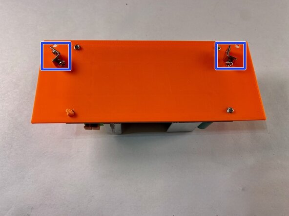

    7. Klipsch Cinema 600 Power Supply Module Replacement, Mount the New Board to the Adapter: step 7, image 1 of 3 Klipsch Cinema 600 Power Supply Module Replacement, Mount the New Board to the Adapter: step 7, image 2 of 3 Klipsch Cinema 600 Power Supply Module Replacement, Mount the New Board to the Adapter: step 7, image 3 of 3
      • Position the Noyito power supply over the 3D-printed adapter board. Drive the four **M3 screws** into the mounting holes to lock it down.
      • Rest the salvaged factory metal L-brackets on top of the 3D-printed adapter alignment points.
      • Insert the factory screws from the underside of the adapter board and tighten them into the brackets. The open holes on these brackets will secure the assembly back into the soundbar casing later.

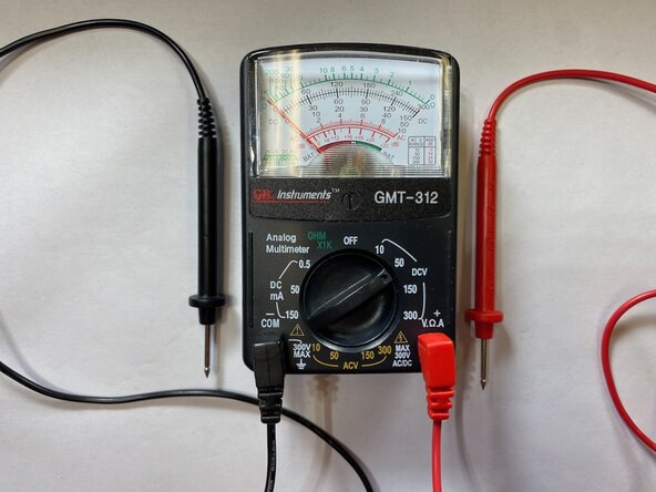

    9. Klipsch Cinema 600 Power Supply Module Replacement, Set Up for Bench Test of Output Voltages: step 9, image 1 of 1
      • Safety Rules: Never touch the exposed circuit traces while the power supply is connected to a wall outlet. Rest the board assembly strictly on a non-conductive surface (e.g., a rubber mat, clean cardboard, or a wooden workbench). Keep your hands completely away from the bottom of the PCB and the high-voltage AC input blocks.
      • Set up your Digital Multimeter (DMM):
      • Connect the black test probe to the COM terminal.
      • Connect the red test probe to the VΩmA terminal.
      • Twist the selection dial to DC Voltage (⎓V). If using a manual-ranging meter, set the threshold range to 200V.
      Ask FixBot
    10. Klipsch Cinema 600 Power Supply Module Replacement, Bench Testing the Output Voltages: step 10, image 1 of 3 Klipsch Cinema 600 Power Supply Module Replacement, Bench Testing the Output Voltages: step 10, image 2 of 3 Klipsch Cinema 600 Power Supply Module Replacement, Bench Testing the Output Voltages: step 10, image 3 of 3
      • Connect an AC power cord to the input terminals and plug it into a standard wall outlet. (Green LED showing power standby.)
      • Carefully match your red meter probe to DC1+ and your black probe to DC1-. Your multimeter should display a steady reading of ~24V DC.
      • Move your red probe to DC2+ and your black probe to DC2-. Your multimeter should read a steady ~5V DC.
