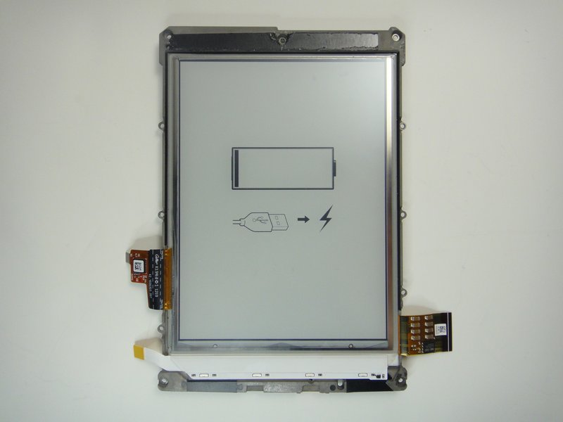

      • Remove the remaining 7 Phillips screws.
      • Lift the motherboard out of the midframe.
      • The screen itself is glued to the midframe. If your replacement screen does not include the midframe, heat the screen with an iOpener and gently pry it from the midframe with a spudger or plastic card.

Whilst this is a lovely example on how to get to the point when you remove the screen best you all be beware the the original Paperwhite (The one I took apart) screen is bonded glass to metal and is practically impossible to clean off. After a great deal of scraping I got to the point where I could fit my replacement screen. Alas all my work has been wasted so far because the replacement screen is not up to scratch. Personally, after attempting replacing the screen I'd pay the £60 to get someone else to replace it.
Flynn Gardener - Reply Share
My replacement screen didn’t come with a frame, so I had to separate old screen from the frame.
I heated the screen and managed to lever it out, but edges of the screen crumbled to glass dust as I pried the screen.
Shot of contact cleaner seemed to allow me to get the crumbled glass out of the glue layer on the frame.
Pretty sure it’s not possible to remove a screen from a frame and not destroy it.
James Halliday - Reply Share
