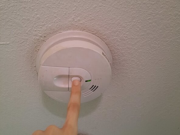

    7. Kidde/FireX i4618AC Battery Replacement: step 7, image 1 of 1
      • Press and hold the test button for 2 to 3 seconds.
      • A single beep during testing is normal.
