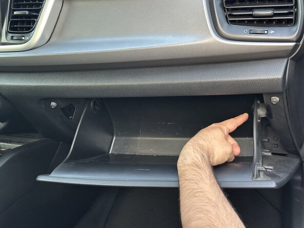

      • Open the glove compartment, empty it, and locate the two fasteners on the left and right side.

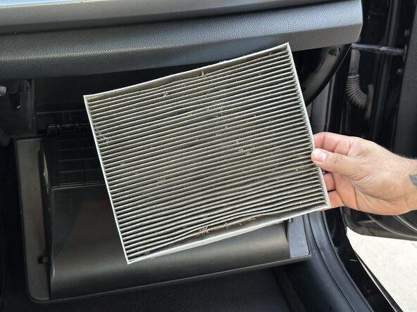

    4. Kia Rio Cabin Filter Replacement: step 4, image 1 of 3 Kia Rio Cabin Filter Replacement: step 4, image 2 of 3 Kia Rio Cabin Filter Replacement: step 4, image 3 of 3
      • Pull out the old cabin filter.
