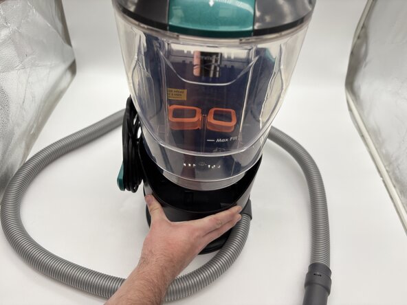

Kenmore SpotLite KW2001 Disassembly
    1. Kenmore SpotLite KW2001 Disassembly, Kenmore SpotLite KW2001 Disassembly: step 1, image 1 of 3 Kenmore SpotLite KW2001 Disassembly, Kenmore SpotLite KW2001 Disassembly: step 1, image 2 of 3 Kenmore SpotLite KW2001 Disassembly, Kenmore SpotLite KW2001 Disassembly: step 1, image 3 of 3
      • Remove the clean water tank by lifting upwards and set it aside.
      Ask FixBot
    2. Kenmore SpotLite KW2001 Disassembly: step 2, image 1 of 3 Kenmore SpotLite KW2001 Disassembly: step 2, image 2 of 3 Kenmore SpotLite KW2001 Disassembly: step 2, image 3 of 3
      • Remove the dirty water tank by lifting upwards to access the inside of the vacuum.
