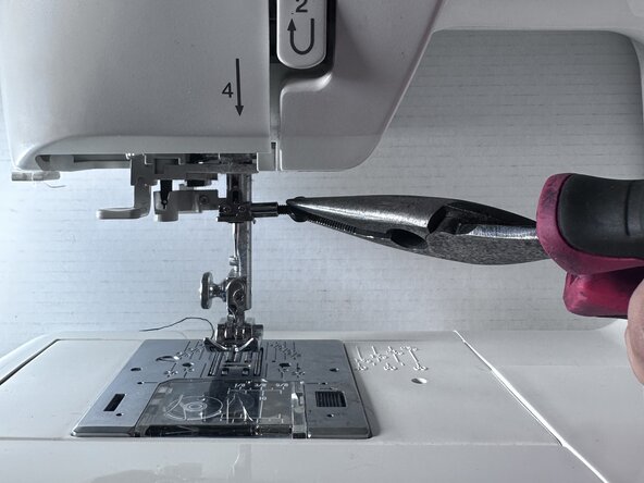

    3. Kenmore 385 Series Needle Replacement: step 3, image 1 of 2 Kenmore 385 Series Needle Replacement: step 3, image 2 of 2
      • Use small pliers to loosen the needle clamp screw by turning it counterclockwise.
      Ask FixBot

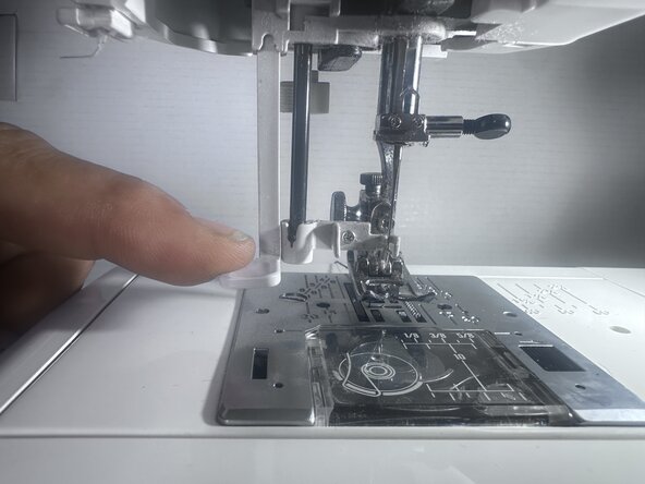

    13. Kenmore 385 Series Needle Replacement: step 13, image 1 of 2 Kenmore 385 Series Needle Replacement: step 13, image 2 of 2
      • Pull the automatic needle threader lever down as far as it will go.
      Ask FixBot

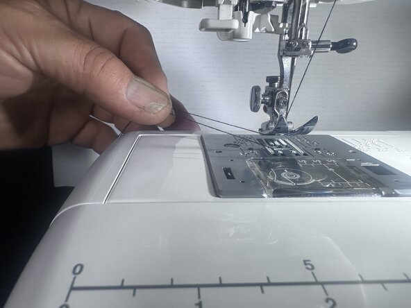

    14. Kenmore 385 Series Needle Replacement: step 14, image 1 of 3 Kenmore 385 Series Needle Replacement: step 14, image 2 of 3 Kenmore 385 Series Needle Replacement: step 14, image 3 of 3
      • Guide the thread around the small hook on the needle threader, then release the lever to pull the thread through the needle.
      Ask FixBot
