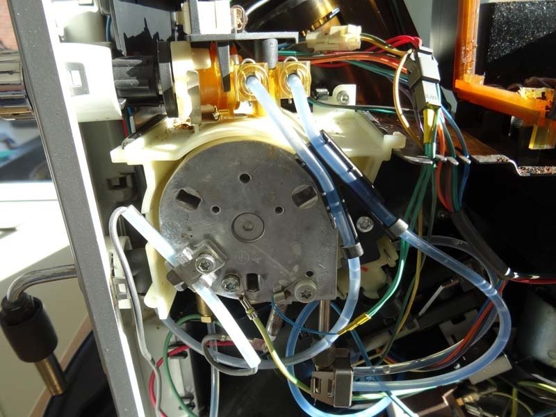

    2. Jura Heater Replacement, The thermoblock: step 4, image 1 of 3 Jura Heater Replacement, The thermoblock: step 4, image 2 of 3 Jura Heater Replacement, The thermoblock: step 4, image 3 of 3
      • The block is marked red here.
      • Older models have a completely differently shaped thermoblock. (Pictures 3). The guide for this you can find here.
      • There are three connections for water or steam.
      • Three cable feeders.
      • A thermocouple.
      Ask FixBot
    3. Jura Heater Replacement, Release connections: step 5, image 1 of 3 Jura Heater Replacement, Release connections: step 5, image 2 of 3 Jura Heater Replacement, Release connections: step 5, image 3 of 3
      • First, pull the clips on the tubing connectors, then pull out the tubing.
      • Then remove the power cables: A gray cable leading to the thermal fuse, a blue one directly from the heater (can also be pulled later) and the green-yellow protective cable is unscrewed.
      • Two small blue cables lead to the temperature sensor, it is unscrewed.
      • The hexagon screw in the middle can be loosened.
      • Unscrew the tube holder, then the block is free.
      Ask FixBot
    4. Jura Heater Replacement, exchange: step 6, image 1 of 1
      • Here lies the block. If you are lucky you can push out blockages from the openings with a wire. Mostly that does not work. The block can not be opened and must then be replaced.
      • This is the thermal fuse. First remove the cable lug, then unscrew and fix together with the cable on the new block, as well as the yellow-green protective cable.
      Ask FixBot
