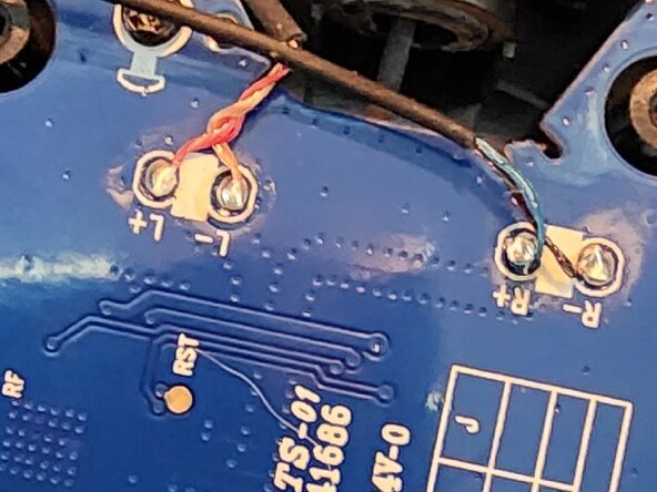

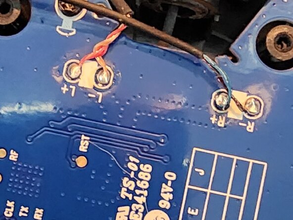

    • To ensure I didn't stress any of the wires or pads on the circuit board, I decided to remove the wires. I warmed up the R-, R+ and L-,L+ pads one at a time with my soldering iron and lifted the wires from the board.

    • Re-attach the Left +/- and Right +/- wires. Warm up each solder pad. Do one at a time, ensuring not to create a solder bridge between pads.
